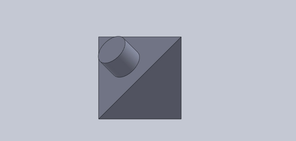

Hi How to create an auxiliary view for a surface or plane that deviates by two angles on front and right planes or any other standard planes. for example: as shown in attached image if I want to create a view that shows a real dimension of circle

What we do with a view like that is in the view that we want to take the auxiliary angle off of we would sketch a line & make it co linear to the center line of the circle. Then we use that line to define the hinge line for the view to be projected off of. This serves two purposes. First it gives us the hinge line & 2nd it makes the auxiliary view driven by that line rather than geometry in the drawing view. We do similar to tools with the compound/auxiliary angles and if we use the geometry in the drawing view from the model & the angle changes, then that aux view does not update properly. If we sketch the line, then the view updates. True the dimensions usually are messed up & need redone but the view remains intact
Hi everyone. sorry I want more explaining, If I was working on drawing sheet and I have a model that has many surfaces for example the sphere in attached image and I want any sector (1,2,3 or 4) to be normal view by drawing tools only. the question is how can I do it.
