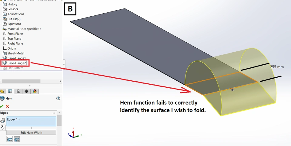

I'm attempting to create cardboard displays that require hemmed edges to provide structural rigidity. For this function, it is desirable to have an extremely tight radius so the material is folded over on itself.
When I create an initial sheet metal part (Base-Flange1) the hem function works correctly as shown in Figure A.
However, after extending the material creating Base-Flange2 the hem function no longer produces the desired results (ref. Figure B).
Any suggestions are appreciated.

Nice!! Have you thought about extending it first then putting your hem on it? You can adjust the "width" of the hem with the "Edit Hem Width" button and it will automatically add a relief in.

It looks to me like you have 2 separate base flanges that are not merged together. If your second base flange is merged together, it will become a "tab" in your feature tree. Also, if you select all of the edges that you want to hem at 1 time, Solidworks will miter them for you.

It looks like you have two bodies in your cut-list.. Is your Base-Flange2 a separate body? And if so, why?

Thank you for your response to this help ticket. To be more clear, I do the extending first and only want the hemmed edge on the end face of the extension. Even after "combining" the surfaces it seems the normal direction is causing the hem to form abnormally. The hem should form on the small face, however it is somehow forming on the larger top/bottom surface rather than the end surface. See Image C... Any thoughts are welcome.

Go back to your base flange 2 and select merge. Dont combine them.

I think there is something going wrong when I combine the parts. After combining, I am unable to even select edges of the other 3 sides of the part to create a hem.... The only edge I can select is on the edge shown in image C. When I attempt to select other edges I see Orange triangles that say "Flip"... I assume this means Normal but no obvious way to flip the normal or how its affecting the hem function.

Thanks to both who answered this.... It became apparent I was not using the Base Flange function correctly. Issue resolved!
