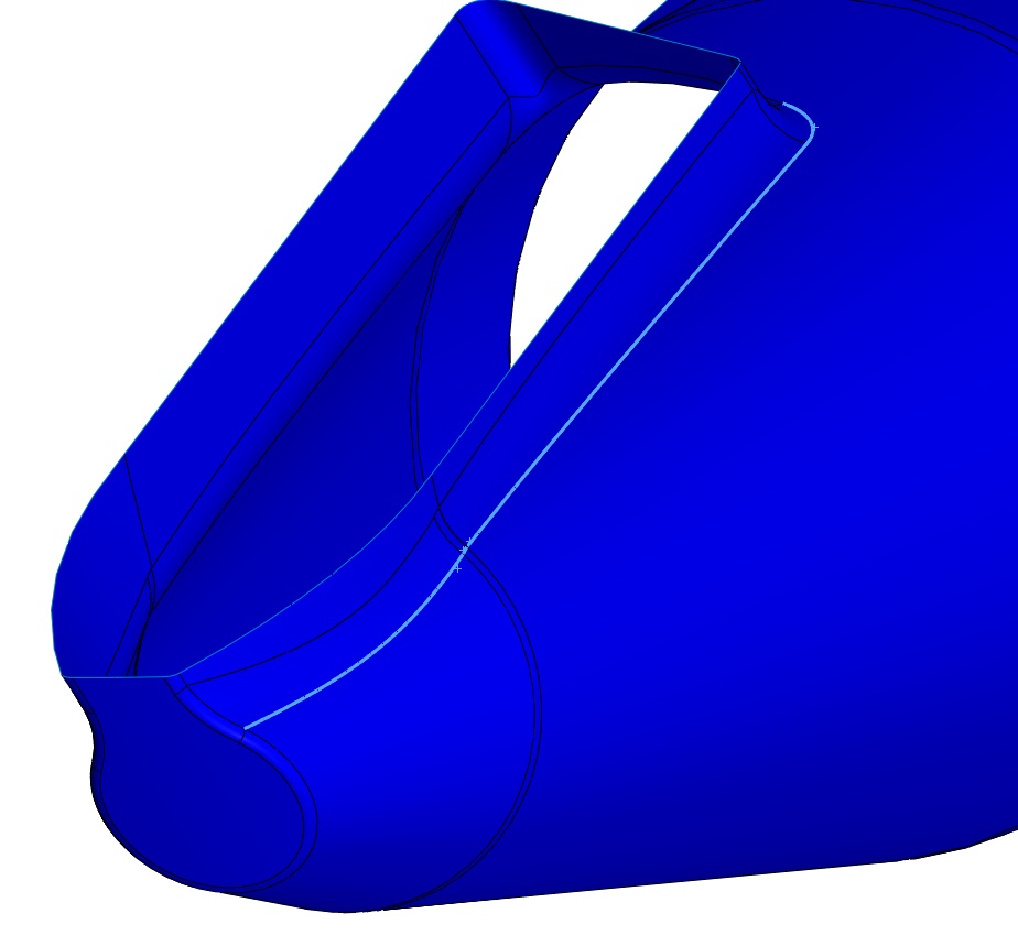

Below is a duct protruding from a cone. in order to get an overlapping layup, I'd like to trim away the cone, leaving 1 inch or so of the surface offset from the light blue line (continuing all around the duct). I've tried a lot of things to approximate this (none have been successful), but haven't even thought of anything that would do it exactly. What I really want is to extend the cone surface negative 1 inch.

Is the Light Blue line parallel with the outlet??
Here is what I would try.  Insert a new 3D sketch and convert the blue line entities all around the part and draw a line to connect the ends and then add a surface there, extend the surface if required, then use that surface to trim the cone...

..maybe use a sweep (tube) and trim... or a fill surface, untrim, offset and trim?

Paul,
This is a great solution--really great. I'm going to mark it correct.
But I should add that our VAR came in for a lunch and learn today and coincidentally demonstrated the offset on surface feature which is new to 2017 and is exactly for this problem.
