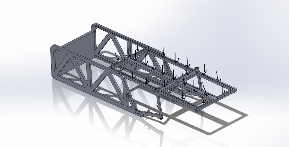

Hi guys. I am a new learner and really need help for my university project. It is a lifting sytem. The problem is, i try to do finite element analysis(stress tensor,deformation) using simulation Xpress. I try to do fea on the platform pin at several point along the path of the frame under certain load. However, i cant proceed because it say it not support assembly part. If i save as the assembly into part, it say it has no solid body. Also do the mating influence the result of analysis? and will anyone teach me how to do analysis. Any idea, help? Is it posible with my design? i attach the zip file for review. Thanks!

Nasrul,
To get a Solid body is one of teh menu choices when you save an assembly as a part. While this may make your assembly go, you are unlikey to get useable results--especially if you are not familiar with FEA. Simulation express is a very limited tool.
SF
SF 2013-11-28
is there any chance you isolate the part you want to study?
you need to run a static simulation.
for contact sets in assembles, this may be helpful
http://www.cadalyst.com/manufacturing/understanding-contact-solidworks-simulation-13526
SF
SF 2013-11-28
What mike said about the import is key here. Save as part, choose the all components option, not exterior surfaces.
You will then need to combine which will also lead to some challenges for a new solidworks user.
But for simulation, you should be able to turn on soldiworks simulation in the addins and run the analysis on the assembly directly. But make sure you have gone through the tutorials and tried some simple assemblies first.
SF
SF 2013-12-02
but remember, no contacts in xpress.
