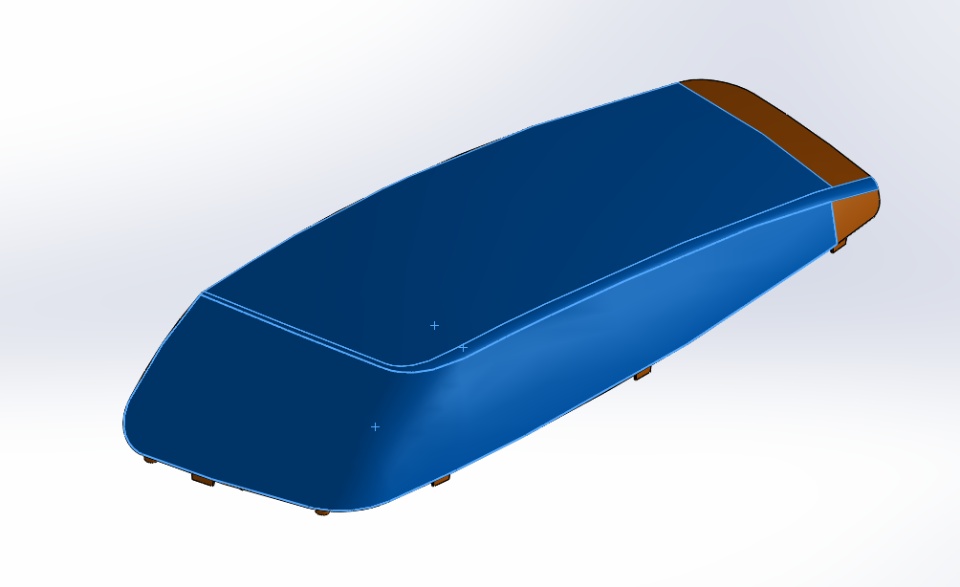

I'm able to use the Delete Face feature to combine all these surfaces into about 5 surfaces. Now I am trying to combine these 3 surface into 1 so I can do either an extrude boss/cut Up to Surface feature (see blue highlighted below):
I tried to do continue using Delete Face feature but it's distorting the surfaces. I've also tried to do Surface Knit but I am not certain how to fully use it because it's not combining the faces. Any suggestion?

Surface knit wont technically combine the faces but it combines them into a single surface body. You can then use that to select "up to body" as your end condition.

The profile of your sketch must lie within the boundary that the surface covers otherwise it will produce an error.

I will say that you may have put in the magic solidwork dust! somehow it worked this time! Thanks!!@
