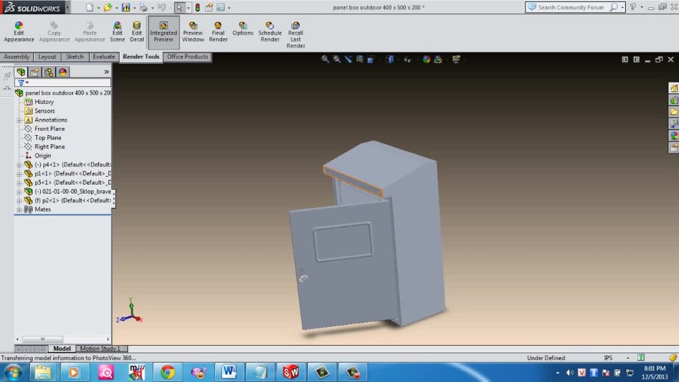

I get this warning when Turn on Integrate Preview and Render windows didn't appear.
http://codientu.org/attachments/1-png.15997/
Answers 11
DG
DG 2013-12-05 Best Answer
The error message is not clear but it seems an indication to use camera view for better perspective image. So click OK and continue
SF
SF 2013-12-05
Thanks for your answer, I click OK and turn on perspective mode then Render Windows appear in moment and disappear after.

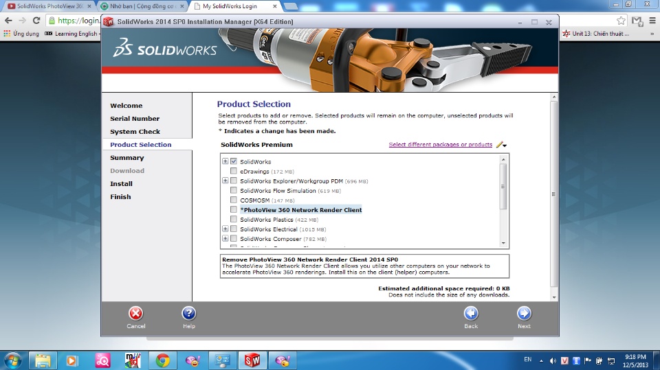

I don't see the Photoview 360 in SW2014 setup. Has SW 2014 have single download Add-in PV360 ? thanks
SF
SF 2013-12-05
I have just reinstalled SW 2014 and did nothing then I used PV360. That's amazing.Thank you!
DG
DG 2013-12-05
PV360 is listed under SolidWorks (expand SolidWorks to see that it is checked).  And from your last post it looks like you're able to use PV360 now.
