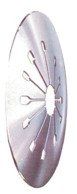

i have made a 3d model of diaphragm spring.
i need to simulate the way it works when force is applied at the center.
but i am unable to do so.
please help. i am only getting deflection in the center part where force is being applied. no deflection is occuring in the outer part of diaphragm.
i am afraid that my fixtures are wrong

can you elaborate on your setup
can you post a picture of the results you are getting

i made some changes, n setup has atleast started showing deflection in outer edge
but it doesnt seem ok to me
i think the fixed geometry constraint which i have applied isnt correct. should i try to apply any other type of constraint? which DOFs should be constrained according to you?

fixed means that it is superglued to something that is superstiff > does that match the condition in "real life"?

From your pictures I would suggest, as a first pass, to delete the fixed constraints you have and apply them to the outer rim/edge under Advanced restraints and set the motion parallel to the applied force equal to zero.  You might also need to apply a radial constraint but hopefully not.

and another suggestion, cut this into slices and run one slice, that will speed up your analysis significantly. and you can also use shells.
