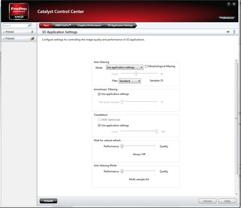

  • I have the "Use software OpenGL" option selected in Tools>>Options>>Performance
  • Just updated the graphics driver to 8.850.7.0 from the SolidWorks website
  • All settings in the Catalyst Control Center are set to default - they are all set to "Use Application Settings" (see attached pic)

Turn off Software OpenGL.
