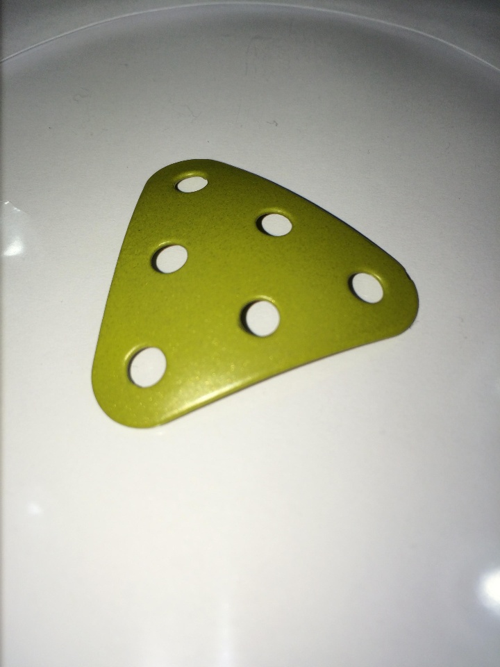

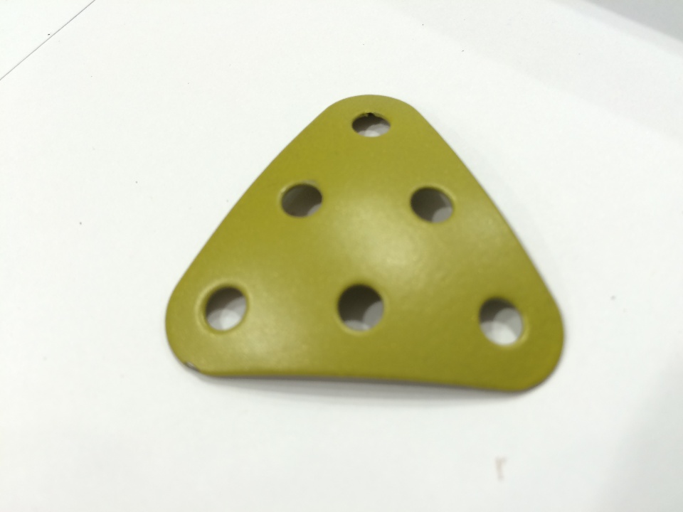

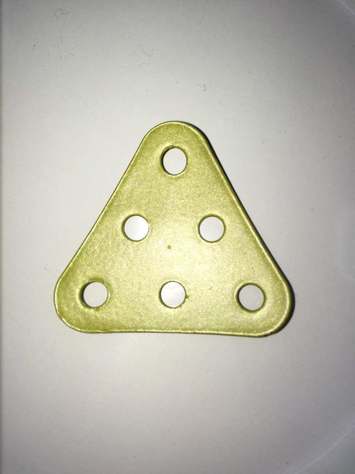

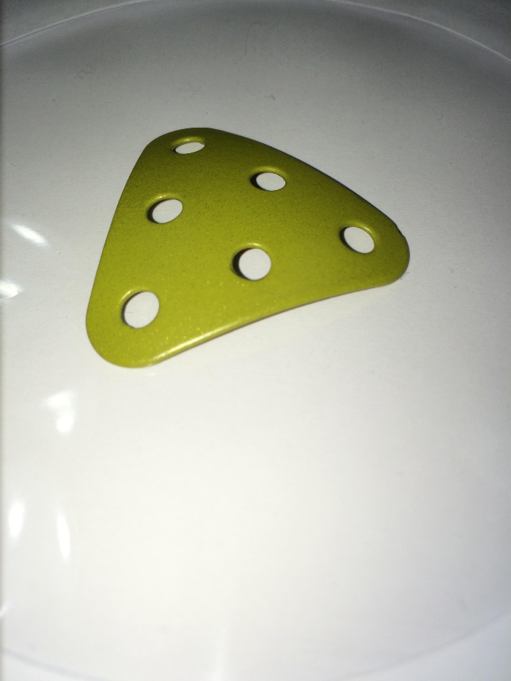

i have to make a part that is a cutout of a sphere with an unknown radius. I cannot figure out how to measure the arc radius of the part to start the drawing. i can answer any more questions about the part if you need them.

Are you trying to measure the actual physical part?  If so, can you post a photo?

Take a photo directly from the side. Take the x and y dimensions of three points and you can calculate the radius. You don't have to calculate it though. Just open a sketch, dimension those 3 points and make them coincident to an arc, and the arc's radius will be defined. I'd do it from three sides and take an average if I cared that much. you can measure the 3 points directly, if you have the right equipment, but it might be easier from a photo--they have to be on a plane, and he photo gives you the projection if you do it right. on the other hand, there are weird fisheye effects with photos that might foul the measurements.

KM
KM 2015-12-22
hei'ya Brandon,
maybe  1 straight edge and a ruler?
or 2 rulers-
see pix below
measure your distance between 2 holes>
@CL (mid-point(mark it with pencil))>
place straight edge(second ruler) along the same line>
measure the gap from surface to straight edge(second ruler) @CL point>
you now have a chord length (eg.50) and arc height- do the math
tip:- check all 3 positions (or others)- to get the average-
as you are using a ruler -
your precision may only be as good as your ruler divisions-
might help? have a good'n kelef
comment imagecomment image

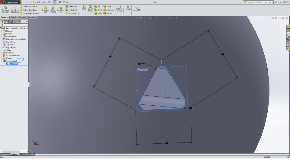

SH 2015-12-22
You have access to one of the most powerful reverse engineering tools.  A regular printer.
Through trial and error you can get very precise by printing a 1:1 scale of an arc cutting it out and placing it over your spheres cutout.  I wouldn't imagine someone made a sphere's diameter 2.81930183.  Its most likely going to be to the closest mm or 1/16 of an inch.
From there you figure its an equilateral triangle and you only have to find out one leg.  So wrap a sheet of notebook paper around the sphere and place a dot in the center of the circle.  Only need 2.  Flatten out the sheet and measure the distance.  That's your arc length.  You can check the measurement by printing the circles on a 1:1 scale at that length.  Also can use that time to verify the circles diameters since you don't have calipers.
Then it's SolidWorks Skills.  Arc length is dimension by clicking on the two endpoints and then the line.  See the symbol of an arc over the .500 dimension below.
The holes were made by a 3D Sketched Hole Wizard Hole.  Don't forget to use symmetry in SolidWorks.  All of the legs are the same distance.
comment imagecomment imagecomment imagecomment imagecomment imagecomment image

SH
SH 2016-01-06
Using a plane inside the 3D sketch and using that for an "intersection curve".  From there it's just a matter of locking down your reference location of where you believe the starting hole is and iterating from there.  There are other ways this is just the fastest and cleanest that I am used to since it stays in the sketch and it's for this sketch.
