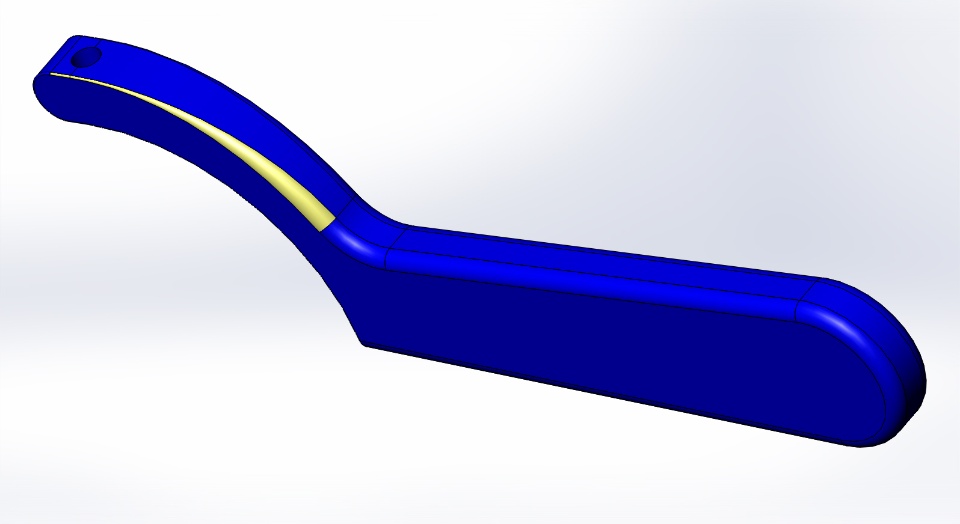

My first attempt at variable radius fillets and I need some direction on how to achieve what I am after.
I have attached a model of a typical spanner wrench. The handle and outer diameter of the curved wrench all have 1/8" radii whereas the tip and the inner diameter of the curved wrench have 1/64" radii. The problem is that the transition from 1/8" to 1/64" is spread out over the full length of the outer wrench curve (see attached image). I would like the transition to occur in the very short segment near the hole.
Your guidance is greatly appreciated.

Can you use a workplane to split the faces (Split Line) for more transistion points?

Daen,
  Try this.
Paul

Thanks for the example. It explains much. As you could see, I had selected ALL the edges. Apparently the software is smarter than that...
Your example selects the long curved edge. I would like to move the fillet transition to the next edge in the loop - the short straight edge next to the hole. When I tried your technique the feature fails. Is there a minimum length edge necessary? Not sure if the failure is from my lack of skill or a software limitation.
I'll try to post a picture.
Thanks again,
Daen

A picture of the real thing I am trying to duplicate.
Wow, first time uploading to forum from cell phone. Definitely NOT habit forming.
