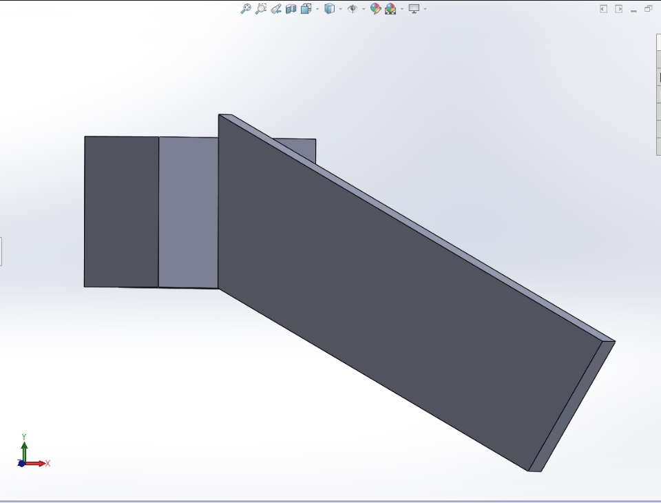

Case 1: (Compound) miter cuts
Let's pretend this is something like a roof truss made out of 2x4 lumber (and lets pretend a 2x4 measures 2" x 4").  There's a horizontal beam, then a joist that meets it 30 deg below horizontal (just a single miter for now).  If I just make the 30 deg miter cut and butt joint the cut face to the beam, it's taller, as the vert. dimension of the cut surface is: L = 4" / cos 30 = 4.62".
So, if I want the cut surface to be flush with both top and bottom of the horizontal beam, I'd need to cut down the width of the 2x4 first.  So I could do math: 4*cos(30) = 3.46", draw a beam as 2" x 3.46" then cut the miter.
But I figured this is easier:  Draw 2x4 profile on front plane, draw a sweep path on the right plane 30 deg below horizontal, then do a swept boss/base, then finally square off the free end such that it isn't mitered.  This also gives me a width of 3.46".  This seems to work whether I select the Profile orientation to be "Follow Path" or "Keep Normal Constant", so I suppose I'll have to read in to the difference between these scenarios to understand better.
Now this is where I get stumped.  Now say this is a compound miter cut: 30 deg below horizontal, and 45 deg back.  Now say I still want the cut surface to be flush with top and bottom of the horizontal beam (so I'll need to wind up with the width of the beam to be 3.46") but I want to maintain the full 2" depth of the beam as it still fits fine.  E.g. I do not want the depth to become 2*cos(45)= 1.41"
So the only ways I can figure it out is I either do math manually to get the 3.46" dimension, draw a beam then make a new plane to perform the compound miter cut.
OR
I do math manually to figure out the projected depth 2/cos(45) = 2.83", then draw a profile 2.83" x 4", make a new plane to draw a sweep path on, then sweep along the path resulting in beam dimensions of 3.46" x 2".
Is there a way to be able to get this shape without having to do any math manually?

SA 2017-08-29 Best Answer
Make your sketch on the right plane and extrude the 2.000"
comment imagecomment image

I get how this is (shockingly) simple for the single miter cut - easier than making a sweep path, but how do I make this work on a compound miter?
Is the easiest to draw the above sketch on a new plane that was 45 deg rotated from the right plane, extrude the 2.00", then use the right plane to cut the second miter at 45 deg?

For case 1, I would model that compound miter in the context of the assembly. Extrude it up to the surface of the mating boards and let the angles work themselves out.
TD
TD 2017-08-29
Yes, exactly (in my text I said 30 deg from horizontal just so they weren't the same angle for clarity, but this is exactly the concept I was trying to do)

Why not just break things down...
Make the 2x4
Add the mitered cut(s)
Add the cut to the top/bottom of the 2x4 so it matches up to the other 2x4
Trying to eat a porterhouse in one mouthful often is more complicated and time-consuming than simply taking bites...

Some of your later examples are more complex, but for this first one (and anything with simple lumber), you should learn to use the weldment tool.  Your miters can be made by trimming the bodies and you don't have to create the profile every time.  Then, if you want to know any of the details for cutting any of the beams to fit, you can just pull them out in a drawing.
...and after further consideration, since you can use all of the usual SW tools on weldment bodies, you could do the more complex joints as well - maybe set up library features for these.
