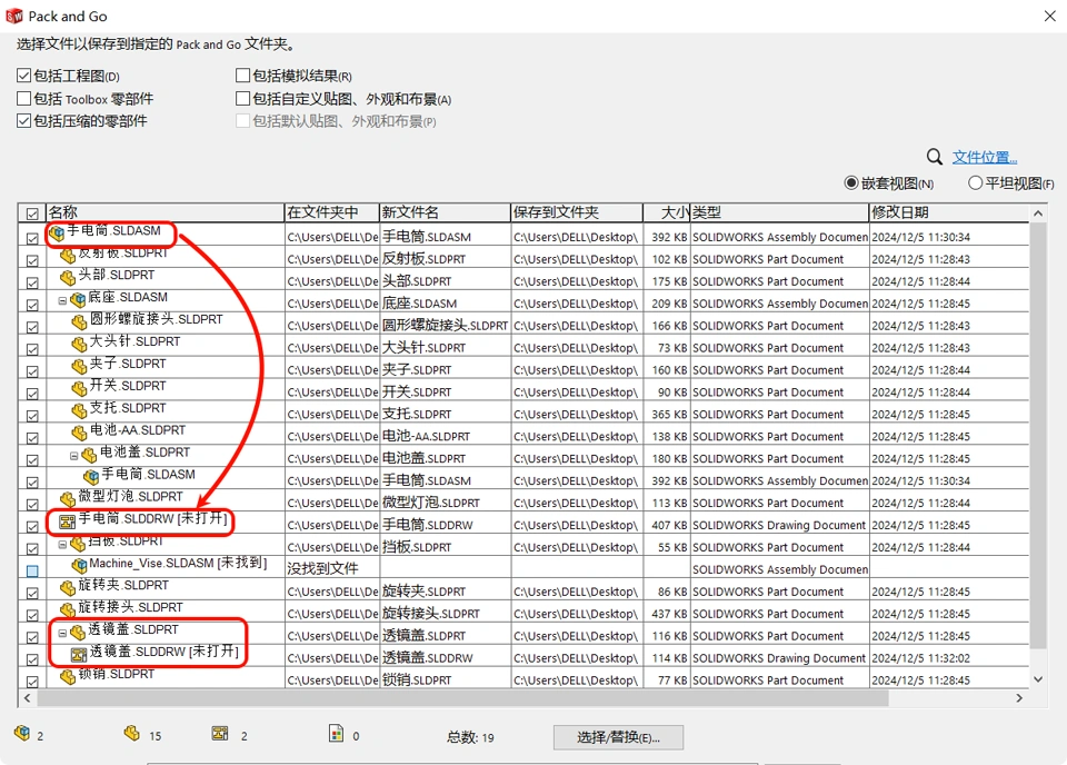

Why are assembly and assembly drawings not together in the Pack and Go interface? The parts and the drawings of the parts will be together.

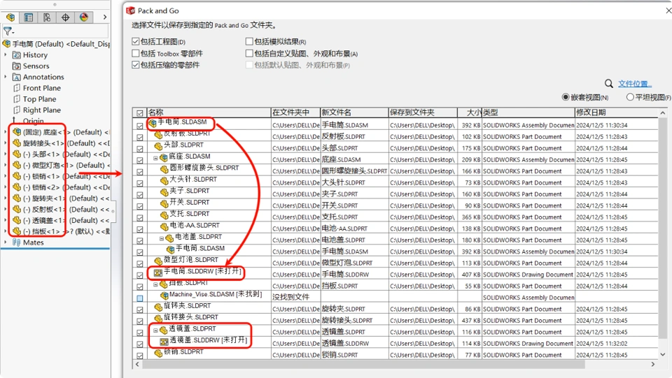

Also: How to make the Pack and Go interface assembly structure the same as the actual design tree structure?

Pack and Go, seems to be working as intended. You get the top level assembly with all the parts then the drawing. So you know what is included between the assembly and the drawing. Windows explorer may be the default for sorting the files in the pack and go window. Some places use the pack and go to make drawings and products fast and on the fly but end up with 100's of the same parts with different names in different folders. It takes some time to learn what you need to do with it and one really needs to understand file management and the product that they are going to be modifying to use pack and go efficiently.
