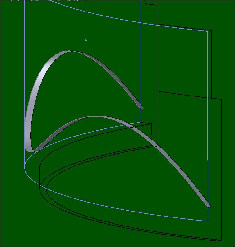

Help...Anyone can flatten this body?
The line has been projected into the face of desk, then the sweep surface has been created, then body has been made by “Thickening” the surface. The problem is that I cannot unroll this 0.5mm thick body. Appreciate your help. Please see attached part and few screenshots below:

Good morning Artur,
Did you want the Gray portion flattened or the other part??

The grey one. The other body is just the ilustration how the grey body has been made..

Thanks for this solution John. That is what I wanted. Appraciate quick answer.

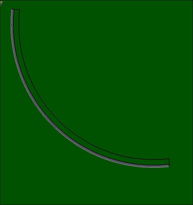

The profile created by flattening the sheet metal loft is wrong. We have machinned it and manually tried to fit it. It doesn't match up the partition profile.

Thanks for continues input in this case. Here are the DXF of right profile (developed to flat using other software) and the DXF of the profile generated by Lofted bend in Solidworks (wrong profile developed when flatten). There is definitely something wrong with Lofted bend. Unless I do it wrong. Part attached as well.

They say "Proof is in the Pudding", personally I don't use the Lofted Sheet Metal feature in SW, more than I have to, because of issues like this.

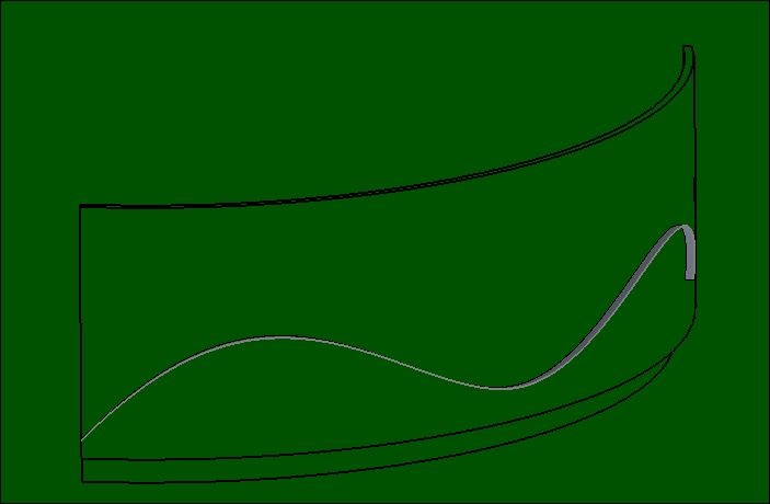

Since this was not answered yet, I thought to give my quick contribution.
Please check the attached flattened part and you may find the animation of this in my website @  http://www.solidcadworks.com/temp-files.html

The only issue with your part, is it would have to be a stamping for it to retain it's shape the way it's designed, because when you look directly at the end of the part you would notice the side walls are twisted, and with air bending there is no way you could make it and have it relax in the state that you show, however your video presentation is good,

Thanks for your input in this case. The profile produced by you is right. You presented video but How did you actally manage to flatten it? What tool did you use?

I used Logopress3.

Please see a response from Solidworks regarding the flattening loft bend sheet metal which produced wrong profiles:
This is a well known problem reported in spr# 19603 "Flat pattern of Sheet metal Lofted bend model creating questionable result"
I have attached this spr to this service request so the customer can receive notifications.
Thanks you for sending me the link, I would agree that I would use lofted bend flat patterns with "skepticism".
R&D are fully aware of these problems and they are looking at future alternative solutions.
