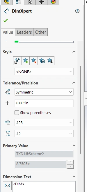

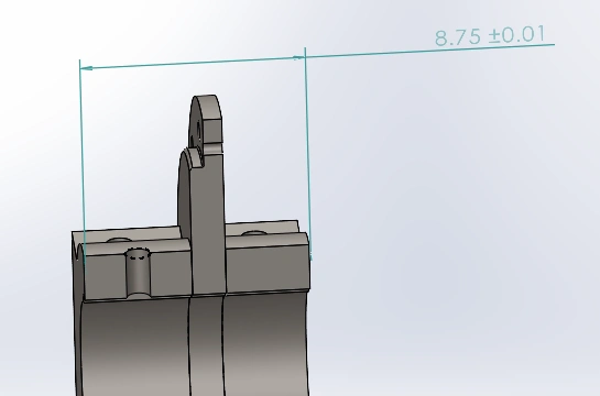

Hello, I have an overall dimension of an assembly that I'd like to be driven by the design table because the piece part dims and tolerances change. When I add the dimension to the individual configuration it doesn't show up in the other configurations.
I think that the dim needs to be in the sketch to show up in all the configurations.
