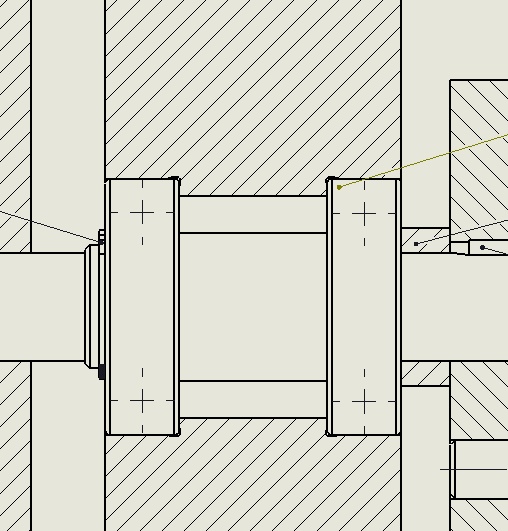

Hello, I have a drawing of an assembly with bearings. Today I changed the bearing from bearings without seals to bearings with seals, but now the bearings are not cut in the section view, can somebody help so that I can update the section view so that my new bearings are also cut?
thank you in advance,

After changing the Bearing configurations did you rebuild?
You can force rebuild using ctrl Q

If the bearing is not cutting in a section, its IsFastener property is set to = 1. Edit the bearing file and delete the IsFastener property, or try setting IsFastener=0.

Check if the new bearings are solids? If they are imported geometry and it's only surface it may be the cause of your problem. Maybe not because I think you will not be able to create the section at all, but it's still worth a look.
