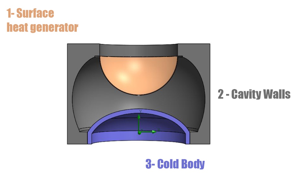

I am trying to do heat transfer simulation that involves a hot plate(surface/body) and a cold plate, separated by an air filled cavity.
The setup looks like in the below picture:
I am running a simulation considering the following features:
type : internal
* heat conduction in solids
* time dependent  120 seconds with 1 second increments
* gravity
The fluid of choice here is air.
Bodies are by default Stainless Steel 321.
Default wall condition is heat transfer coefficient of about 35 W/m^2/K and temperature of external fluid 293.2 K and roughness 0 micrometer.
First, I set up the fluid sub-domain, the air inside the cavity.
I then set up body 1 as a volume heat generation and set it to 20 000 W.
I assume that the walls have their default condition but I have also set them up with heat transfer coefficient individually towards the same result.
The results I am getting are the following:
The heat transfers to the walls in the top region as well as the air inside which heats up. HOWEVER.. the air does not seem to transfer any heat anywhere. It seems that the heat is only from the heat generator towards the bodies/fluids it comes DIRECTLY in contact with.
What I need is to see how the heat transfers from heat generator -> air -> cold plate.
Any suggestions on how to do that? Is there something I am assuming or doing wrong?

First of all, I would not use a default heat transfer flux on all the walls, unless you know for a fact (derived experimentally) that is the case in this scenario. You chose a very specific number as well, where does that number come from?
As for the air, use the geometry check tool and click "show fluid" to make sure you have air where you think you have air. You mention a subdomain, but this is an internal flow problem with only 1 domain, so there might be some confusion here.
What boundary condition do you want to apply to the side walls of this cavity? Are they adiabatic or constant temperature? How do they interact with the energy transfer between the hot/cold plates?

Actually, I was a bit unsure what boundary condition to use on the walls.
I was looking over on this site Overall Heat Transfer Coefficient and chose an approximate value from there, just for a test run to see if something actually happens. I am willing to do proper calculations for it next time.
I understand your point about the subdomain confusion. However, the cavity is water tight an when I click on subdomain and select AIR it shows me the filled space as a fluid region.
The walls should not be adiabatic and they are connected in the top side with the hot plate and in the bottom with the cold one.
Let's just assume that air is trapped in that cavity.
Heat comes from the pink part, transfers through the captive air and warms the blue part.
I am interested to see this transfer of heat, from the pink part through the fluid region and on to the blue part.

As far as the walls, you still need to think about the boundary condition on the outer edges. The question is, do you want heat to be able to escape through those walls, or will it all be transferred to the cold plate? If it's the latter, make sure you create an adiabatic condition on the outer surfaces of the walls. This will trap all the heat inside the calculation domain and still enable heat conduction through the walls as well as convection via the air.

OK, I see you used a constant temperature of 1000K for your heat source and ideal wall conditions for your cavity walls. Why the ideal walls though? I'm not sure what you were going for there.
You had the "exclude cavities without flow conditions" option turned on, that's why there wasn't any fluid in the cavity.
The real issue here is that you don't have a heat sink. Without anywhere for the heat to go, the entire solid and fluid domain will simply heat up to 1000K and stay there.
Here is what I did instead:
Added volumetric heat generation sources (equal and opposite on the hot/cold plates)
Suppressed the wall conditions. It seems like there's an assumed adiabatic condition on the boundary of the domain, so that's fine.
Here's a snapshot of some quick 'n dirty results, proving that the boundary conditions work:
You'll note I used 20W instead of 20,000W like you have in the original posting. I'm assuming that was a typo, since that much heat will completely incinerate this steel assembly.
By the way, this simulation would be a good candidate for symmetric domain conditions. You could simulate just 1/4 of the domain with symmetry in the X and Z axes and have a much finer mesh.
