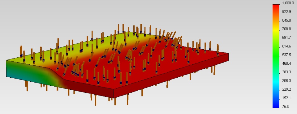

Attached file shows print of a heat flux simulation, the problem I am having is how to remove the heat flux indications from the print of the study.

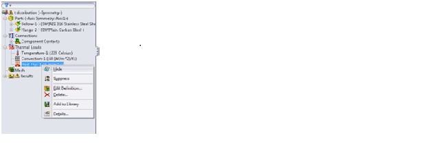

You should be able to right click on the heat flux in your simulation manager tree under temperature loads and tell it hide.
SF
SF 2012-01-26
Hiding the heat flux in the simulation maqnager tree has no apparent effect.  If I animate the studynd save the animation as an avi file they dissapear but not on screen when the abimation is running or paused

In the menu up top select View>Simulation Symbols.  If you deselect this option it should remove them all from the graphics area. You can also access this option from the heads up view toolbar at the top of the graphics area.  Click on the little pair of glasses then select the icon for simualtion symbols.

Thankyou, that was it.  I am new to simulation and still sstumbling around a little
