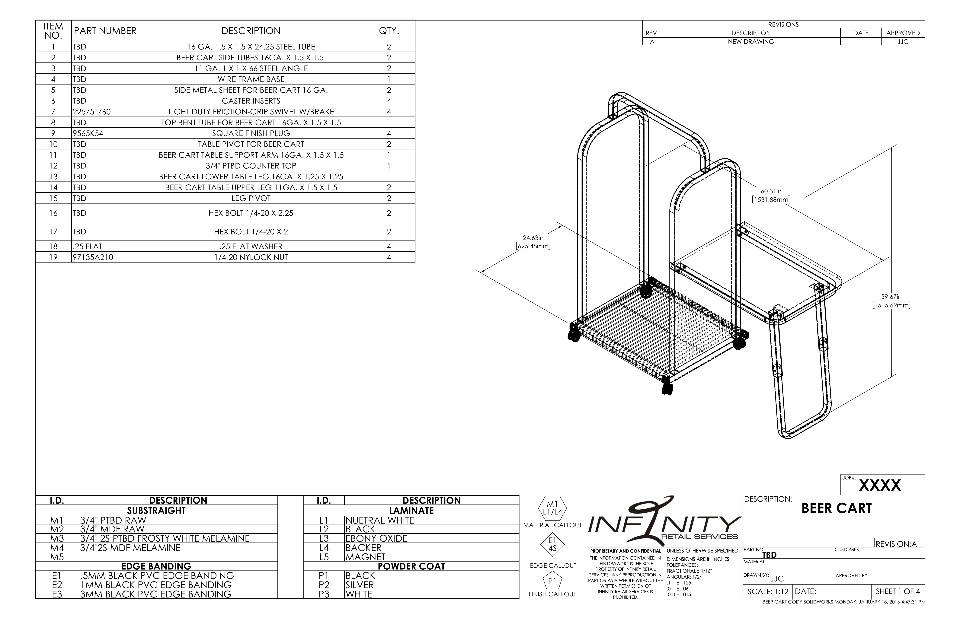

Having trouble linking values from a part to the drawing.
We just upgraded to release 16 sp1.0.
I have sheet formats that reference part description from the part or assembly locations. Now in 2016 I can not get the description to link from the part. When I add an assembly, that has multiple parts, I would make a drawing with the assembly, following tabs would include the parts. Now all the tabs use the assembly description and I can't even get to the part description using the Link to Property dialog box.
Frustrated.
