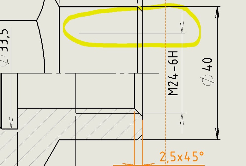

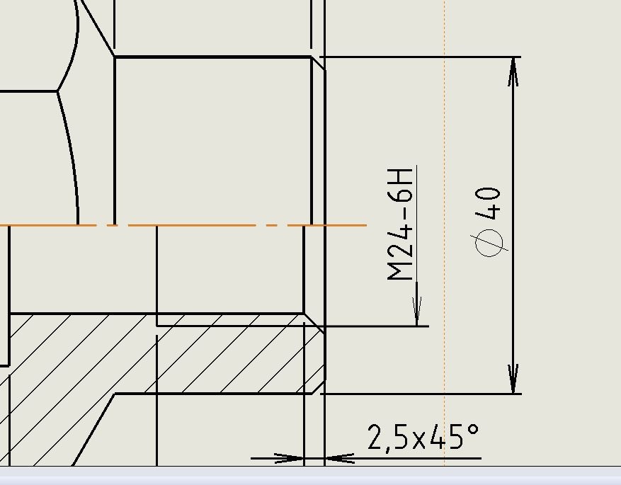

I'm student and I have to create drawings exactly like originals. But problem is that I don't know how to create dimension - half diameter with dimension tool.
I enclosed screenshots of bad dimension (diameter.JPG) and almost good looking half diameter (half-diameter-thickness.JPG). In the second one I used Note tool but I need constant thickness of line (0,35 mm) and I couldn't figure it out.
Btw I created 2D drawing from 3D model.
So how to create this dimension?

MK 2013-10-23 Best Answer
If you right click on the original dimension, I believe you can individually hide the dimension line and extension line you don't want.  Right click on the lines you want to hide, and look for the command.
TC
TC 2013-10-23
RMB on extension line and select hide, same for dim line.

Thanks a lot! I forgot to try RMB on extension line.
But one more thing - how to reduce length of dim line? Now I have too long dim line (see in pic below)
comment imagecomment image
CE
CE 2013-10-23
Click on the dimension and look to the left, click on the leader tab and click custom text position and change it to the last option.  It looks like your dimension is above the line instead of inline with it.
Hope this helps!!!
Chris
SF
SF 2013-10-24
Oh, sorry for my question. I found solution. It's the same as above. You must click by RMB on the edge of dimension and select Hide the extension line. But thanks a lot for your attention!
