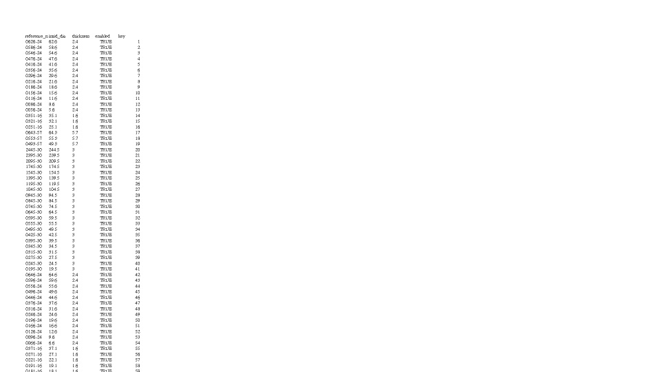

Hi I need  to add the range of  BS 1806 O-Ring sizes  to BSI_DATA_ORINGS_TYPE1 table 500 sizes!  Idon't want to add each one one by one so I exported the the table to excel and added the sizes. See attached excel file. I have  imported it back into excel using the wizard. But I cannot see the addtional configurations is there another  table I need to  manipulate?

Hi Tony the value true is equal to -1, but  it is something to do with how the reference number is related to the part.
Which is why it doesn't work. I am wondering how the tables drive the part in terms of the reference number. I understand that the way toolbox is setup to only add one primary key row at a time is because the OBDC connection is a heap of rubbish, As it has to transpose the tables from access to VBA array and back again. Fricking hated coding vba arrays to access as it was easy to screw up cause of transpose. Please note I am not  much of a coder or database guru I only understand the basics.
What  I would like to do is save O-rings_BSI.sldprt as O-rings_BSI1806.sldpart and  have a table  BSI_ORINGS_TYPE1806 with the  sizes I have posted but as I say I am not sure how the reference number value column works with the part.

BS-1806 :1989  yes i know it is an old standard but the company want to keep using this standard. The reference number is what  confuses me, how dose it work there is no help files on how toolbox application uses SQL calls on the access tables and fills the variables to drive the part.

First off I would just create this part with all the configurations in your design library. You will have less problems in the future. I only modify the toolbox to add holes to the hole wizard that is not there and I have copied all the parts that we use from the toolbox to our own design library, you will find that most people on here create their own design library. If you still want to have this oring in the toolbox here are your steps to do it:
1. Copy the part file o-rings_bsi and name the new file o-rings_bis1806.
2. Copy the BSI_Cfg_ORINGS_TYPE1 table and name the new table BSI_Cfg_ORINGS_TYPE1806.
     a. under the ValueList column change the "4518" to "1806".
3. Copy the BSI_DATA_ORINGS_TYPE1 table and name the new table BSI_DATA_ORINGS_TYPE1806.
     a. this is were all your new sizes in your spread sheet will be.
4. In the BSI_TYPE_ORINGS TABLE copy and paste the first line.
     a. anywhere you see "4518" change it to "1806".
     b. under the filename column change bsi\O-rings\O-rings_BSI.sldprt to bsi\O-rings\O-rings_BSI1806.sldprt
     c. under the ConfigurationTable column change +Cfg_ORINGS_TYPE1 to +Cfg_ORINGS_TYPE1806.
     d. under the DataTable column change +DATA_ORINGS_TYPE1 to +DATA_ORINGS_TYPE1806.
