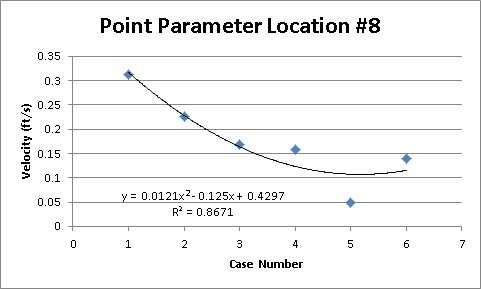

After all simulations finished, I compared Velocity at several points (using point parameters) and plotted the values from each case.  What I am finding is that the values don't seem to be converging, and in many cases are oscillating as much as 20% from one case to the next even at the highest mesh levels used so far.

I added two more configurations with more mesh cells and ran the simulations last night, and I am getting even more divergence.  Do I need 10 or 20 million cells to solve this problem?
My plan was to run somewhat uniform grids (using manual settings) at a few levels, compare results and show what level of grid resulted in less than 5% difference in velocity values, then run the simulation again using automatic settings.  Then I would compare the velocitty values from the manual and automatic grids to show that the automatic settings produce results that are just as good as the manual settings (with hopefully many fewer cells in the overall mesh).  So I would have a GCI value to report for the manual mesh settings, and I would be able to state that the automatic settings produced results that were just as good.

why does the solution need to be within 5% convergence?
overall from what you're showing me, you need more cells
or you need a bit more tolerance for the accuracy of the results and where you're measuring the results

5% difference is a fairly commonly used value I've seen in literature when assessing grid independence.  Honestly, I'd be happy with 10% right now if I could achieve it.  I never expected to see the velocity at one point change by that much as I increased the number of cells in the mesh.
Here's a link to a procedure similar to what I'm trying to do:  Computational Fluid Dynamics (CFD) Blog - LEAP Australia & New Zealand | Tips & Tricks: Convergence and Mesh Independe…
Regardless of whether I use 5% or 10%, I need the solution to be in the asymptotic range to have confidence in the results.  I'll try a few more simulations with denser meshes and see what happens.
SF
SF 2015-01-12
5 or 10% is certainly possible but i think you're going to have to really dig in and look at whether those parameters are convergable
for example if i had a point parameter in a natural convection analysis, i don't know that i would be confident that value would converge
but the average value over the whole computational domain should
