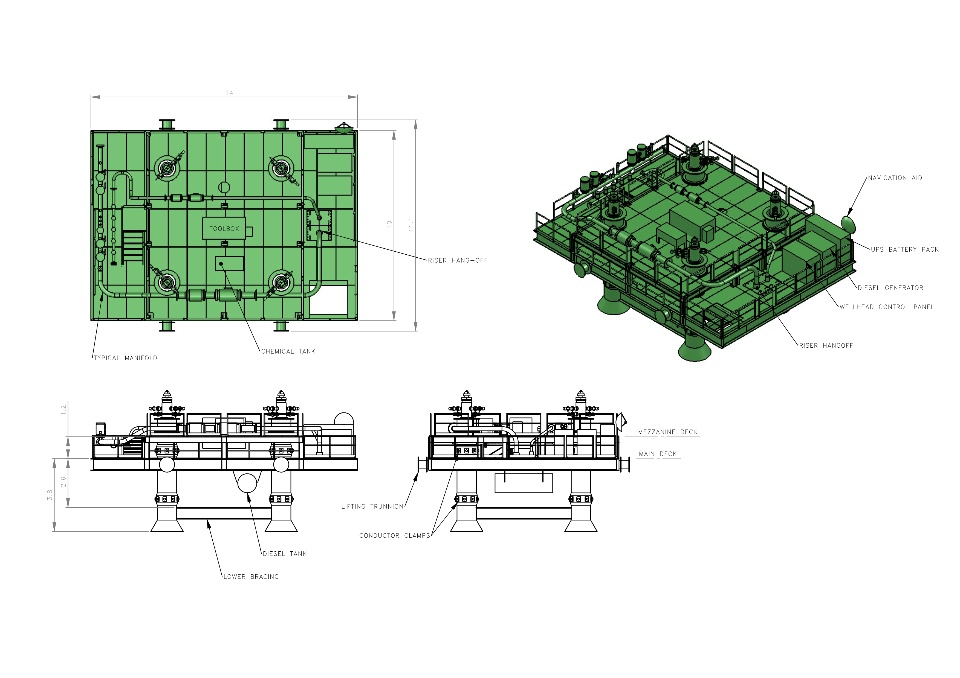

Green views in drawings
In SW 2009, the parts are green in shaded views.
Last week, normal colour was in order!
I have tried:
- rebooting everything,
- opening the model and refreshing, then returning to the drawing. This sometimes works at first, then returns to green
Graphics card: Quadro FX 1800
Thanks,
Fraser

Check you havnt applied an assembly level colour

Doesn't seems to be a video problems. Make sure you didn't applied any appearances to the part.

Greg and Deepak,
thanks for your suggestions.
I have not knowingly put any appearances on the parts or assembly, or changed colours out of the ordinary.
Other assemblies seem to be ok on my PC.
Most spookily, soon after I posted the question, the drawing started to behave itself.
I am still interested to know how it was caused.

Solidworks has applied appearances for me in the past, without any import from me at all..... may be worth a check.

When weird things happen like this, if you can somehow find out the sequence of commands you might
have used that triggered it, you may want to try running the Solidowrks RX tool found in Start>All Programs>
Solidworks>Solidworks Tools.
This file can be sent to Solidworks and more often then not they can pin point the cause.

If the views are green I would suspect it may be caused by the "Sustainability express" addin
I am glad things returned to some semblance of normal for you. It sounds like another unsolved mystery that some of us have run into.
