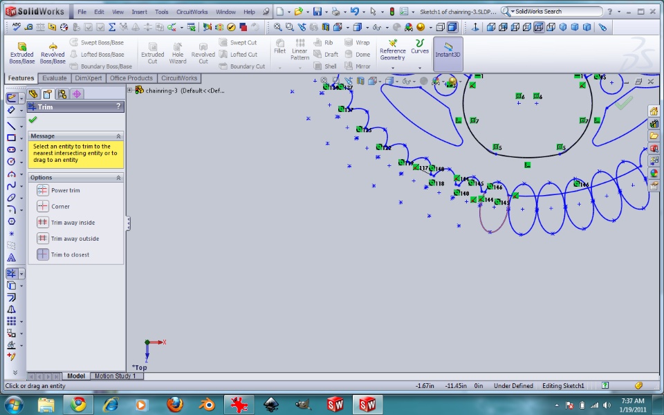

How do I get rid of the green dots when I'm editing the drawing.
I am trying to dfx this drawing but the edges do not show on the dfx output.
What do I need to do to have the outside show on the dxf.
See dfx file.
thanks

Uncheck Sketch Relations under View menu.
Craig,
FYI, those green dots are the symbology showing your constraints.
thank you.
I just wanted to learn how to toggle them. it's easier to read at times.
what about the dxf output? why am I losing splines?
Craig, I see the same behavior here but unfortunately I can't investigate right now. But if you extrude the profile and then create the DXF, it works fine.
