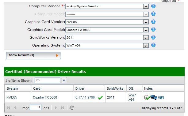

Hi Jeff,
DELL themselves have not certified a driver for the T7400 for Windows7.
In this scenario, we recommend you search on the nVidia Quadro FX 5600 itself (for "Any system vendor").
Hope this helps.
Ron

Kelvin, I am currently using the generic (non Dell) driver 8.17.11.9790 and it is crashing on me.
I have not tried a driver directly from NVIDIA yet though I'll give it a shot.
I'll let you know how that turns out.
Thanks

Ron, this is the driver that I was currently using and it was crashing as well.
I have installed the latest driver directly from nVidia that was suggested by Kelvin and we will see what happens. So far so good.........(fingers crossed)
