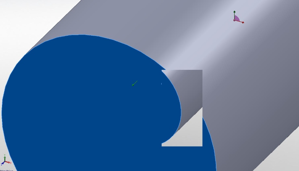

Hi,
A lot of times, if I click the right button (to see a submenu) andafter make a zoom (with de scroll)... only zoom the part of thepart behind the menu. The rest of the part does not move. Thishappens with a simple part or with a big assembly, indistinctively.
I reinstalled a lot of times. I used a WinXP x32/x64 bits, a VistaUltimate x32/x64 bits witch SW08 and SW09 with different Servicepacks of SW. All of this combined with 5 types of motherboard andCPU (Asus, Gigabyte, Core2Duo, P4, AMD Athlon 64, Workstationmotherboard, Games motherboard) and with 3 graphic cards (QuadroFX4600, FireGL v7600 and FireGL v7700). I test all of this with thelatest drives of Nvidia and Ati, and with the certificate driversfor SW08 and SW09. I've done all of the possible combinations.
How you can see... I test ALL but... don't work.
Where de problem might be? It's impossible to work well.
PD: Image of the problemSolidworksAdministration

SF 2009-01-08 Best Answer
Hi mail.
Although I don't have a solution for you, I also have this problem.
I'm using a vista business machine (dell m90) with a Quadro Fx3500M graphics card. I have realised that if this happens I have todouble middle mouse button (zoom all). Which is the only way to getit to show normally / rotate furiously and then just use the"previous view" button to get back to my original zoom.

JL 2009-01-08
One thing you can try. With nothing loaded in SW, change touse software OpenGL (TOOLS>OPTIONS>PERFORMANCE). This willlet you see if it is something with your graphics card driver. Wehad to do this with a system we just updated and had the latest SWcertified driver using a Quadro FX 370. The newest of the 2 SWcertified driver would leave ghosts and not refresh the graphicswindow but the older one did. Newest drivers do not always seem tobe the better ones to use.

Hi,
I tried this (only with small parts or assemblys, because thehigher can´t move with OpenGL soft) anb the problemcontinuous.
I tried with a lot of Certifiqued drivers of nvidia and ATI(fx4600/FireGl v7600/ FireGl v7700) and a lot of OS

AW 2012-12-04
Do you have a Windows Aero desktop theme enabled?  If the answer is no, you need to enable one.

CM 2012-12-04
I am using the "Windows 7 Basic" theme.   I usually dont use the default "eye candy" themes in Windows, since Id rather my graphics card focus on SolidWorks.   Are you saying that having the less graphic intensive theme actually causes issues?

Chris,
  Yes indeed it does, check out this explanation: https://forum.solidworks.com/message/329574#329574

Thanks for the link, interesting.  Ill give Aero a shot to see if it fixes my problem.
