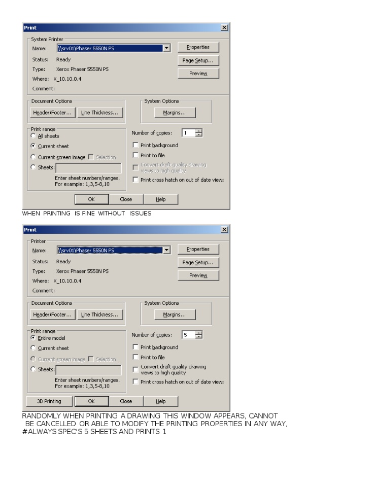

I have a random problem, click to print and the print window will be displayed 3d printing is dispalyed rarther than the normal document printing window.  This would not be a problem, however the program seems to be locked into printing all sheets once, the user is uable to cancel/exit the printing window without the action being carrried out.  If I repeat the action at a later date the standard printing window will pop up and allow full modification of settings.

Can you post images of what you are seeing?

Attached is a screen dump of the two different printing window pop-ups that appear, explaination under each screen dump

Weird that it is the same printer.   One thing I would becareful of as a side note
that you are printing drawings on paper and not doing true 3D printing as in printing
out 3D models that you can feel and touch and use.
Anyway, I am wondering if your printer is not capable of handling this file and is
short on memory. so therefore it hangs up.  Does it do this on other multi sheet drawings?

The glitch is purely random on all machines with solidworks
