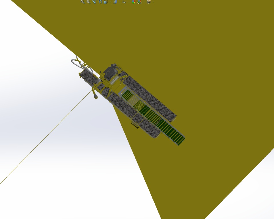

Hey Everyone
I am Using Solidworks 2014
I am trying to Get rid of the Golden BackGround/Plane Looking Surface
I opened up my assembly and There is what seems to be a  Huge Plane Like Surface which disappears eventually as i continually Zoom Out .
I cannot Highlight it , so when i click the surface and Create a Selection box to Highlight it there is no Response from Solidworks
It does not disappear if i change all my View setting i tried shutting off Planes Annotations etc but the results are the same
I tried closing up the drawing and reopening it and the problem presists
Has anyone ever encountered such an Issue
all Feed Back is Appreciated
Thank You

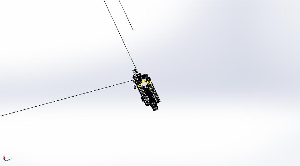

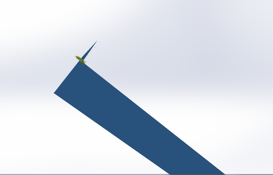

Im adding a Few Images please Review
The Image Below is when the Assembly is Set to open with "Shaded"
This Image is off the same Golden BackGround when the Assembly is tuned to " HIdden Lines Removed"

I Got it to Highlight ..Zoomed Out Furthur More and Then selected
All my Backups are showing the Same Issues

Run the SolidWorks Rx tool to check the graphics driver.

Is the assembly an imported assembly from another cad program, or any parts likewise?

Kelvin Thank You
I Ran the Rx. The drivers have been updated the issue presists though

Greg its an Assembly that initiated in Solidworks and is not imported from any other program

Try suppressing all your parts in the assembly, and if the problem goes away unsuppress one part at a time and see if the problem is part specific, then if you can post the part here to check.

You had the Right Idea
The Issue was with a Part ( Sheet Metal ) that is from an Older Version of Solidworks ( 2013)
I am going to see if I can resave the Part and Solve the Issue That way or maybe Recreate it if Nothing Else Works
