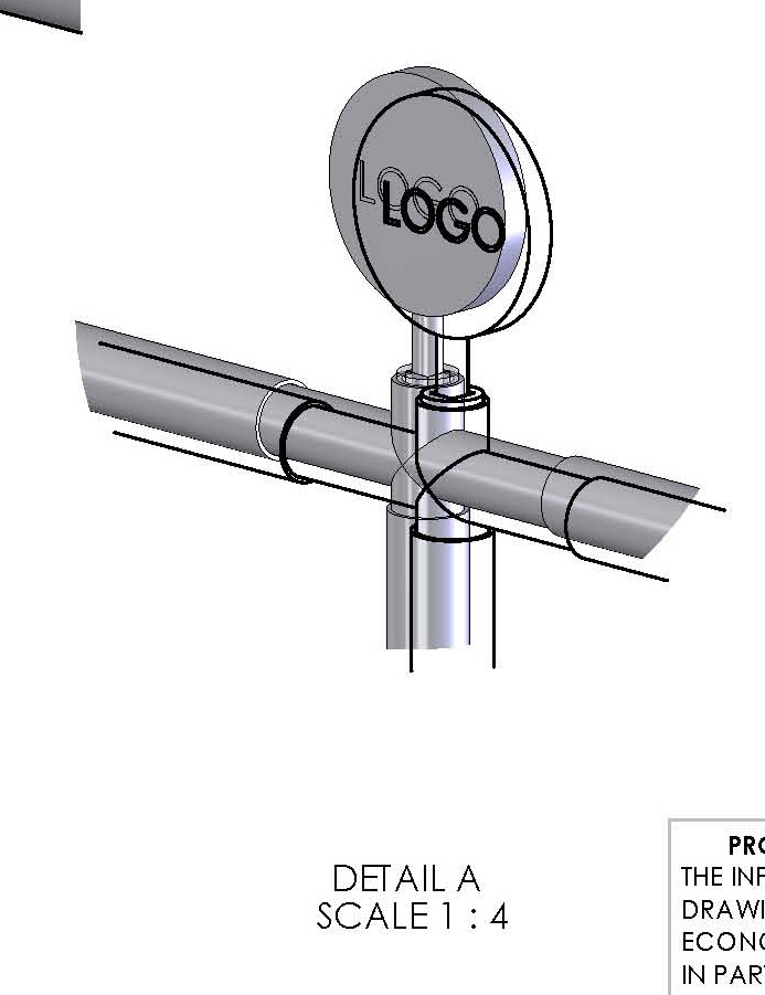

Getting wierd issue when saving a drawing out to PDF
The Problem occurs when the detail view is not on the same sheet as the primary view, both views are shaded.
As you can see from the attached JPEG the detail view in the PDF comes out blurry.
Anyone have any suggestions?
Solidworks 2008 SP5
Dell Precision 690
Windows XP Professional 32bit
NVIDIA Quadro FX350, With Solidworks Certified Drivers
Xeon Dual Core CPU 3.2GHz

Have you tried creating the same view again or changing the view type?

Yes I recreated the view, this is when I discovered that If its on the same sheet as the primary view it works fine.  It only when it's on another sheet.
I developed A work around by inserting the full view on the second sheet and just cropping the view and them manually inserting the detail call outs and circle.
Also if I switch to HLR or HLV it works fine.
Normally I don't do this, but this was a requet by a customer to see a close up of a specific component.

If it is repeatable, perhaps send the files into your VAR to evalute for a potential bug (assuming you are using 2009 or 2010).

Matt, I'm not getting a clear understanding of your problem from the JPEG you posted.
It looks like your HLR view is exporting as draft-quality.   when you export your PDF, select the 'options' button in the saveas dialog(after you change the filetype to PDF).  Once there, make sure the high-quality button is checked.
I don't know if 2008 still has draft-quality views, but you might check your detail and see if there's a draft quality button in property manager.
try messing with those settings and see if that helps the situation.

Yeah I have HQ selected in the options Dialogue I will mess around with some settings.

Have you tried sending the drawing to a PDF Printer, instead of doing a SW Save as?
