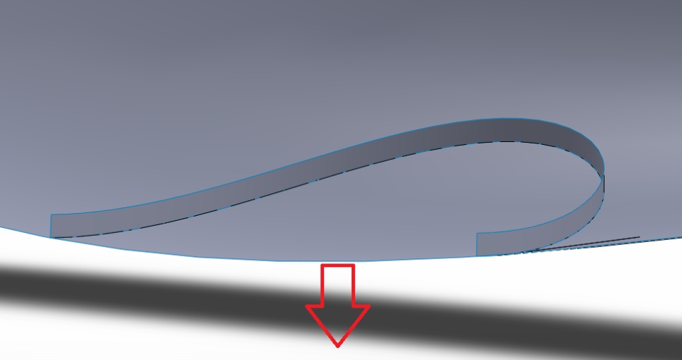

I am attempting to create a macro to automate the CAD creation.
However, the ruled surface created is not in the intended direction.
Shown here is my code:
boolstatus = Part.Extension.SelectByID2("Top Plane", "PLANE", 0, 0, 0, True, 0, Nothing, 0)
boolstatus = Part.Extension.SelectByID2("", "EDGE", 0.135976039502168, -2.97543949024544E-02, -2.66014941007029E-02, True, 0, Nothing, 0)
Part.ClearSelection2 True
boolstatus = Part.Extension.SelectByID2("Split Line1", "BODYFEATURE", 0, 0, 0, False, 0, Nothing, 0)
boolstatus = Part.Extension.SelectByID2("Top Plane", "PLANE", 0, 0, 0, True, 1, Nothing, 0)
boolstatus = Part.Extension.SelectByID2("", "EDGE", 0.135976039502168, -2.97543949024544E-02, -2.66014941007029E-02, True, 4, Nothing, 0)
Set myFeature = Part.FeatureManager.InsertRuledSurfaceFromEdge2(2, 0.002, True, False, True, 1.74532925199433E-02, False, 1, 0, 0, True)

So as per my understanding, I need to change the value highlighted in Bold to get it working.
However, no matter setting it to true or false, the direction remains the same when the CAD regenerates it.
Please help out if anyone knows what went wrong.
Attached is the CAD generated and also the intended direction highlighted by the red arrow
