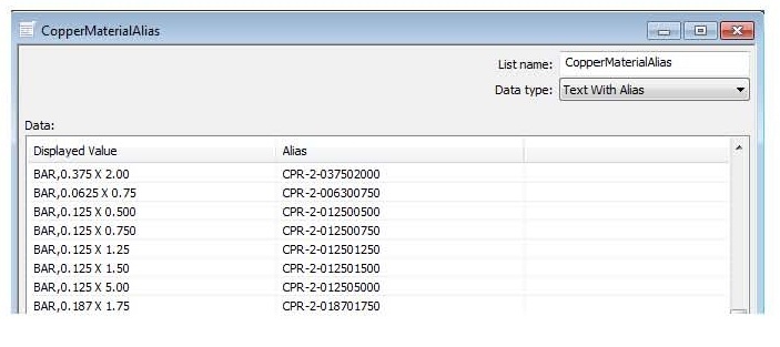

Getting two variables from an Alias data card list
Is there any way to get both of the columns from an Alias card list (displayed value and Alias) to create two variables (StockType and PartNumber)? I need both pieces of information in the meta tags of the part.

          We have faced the same problem.It is not possible to use "Display Data" when using List with Alias.For this we did a workaround.
1. Created list with entries as follows (DiplayValue*Alias)
BAR,0.37X0.45*CPR-2-0034245554
BAR,0.38X0.46*CPR-2-0023424455
User selects one of the value from this list and using input formula,the value is divided and stored in two variables.
Looks ugly on card,but does the job.

@Ravi, Great idea. I love it. I may be able to help you with the "ugly" list. See my reply to Craig below.
@Craig, Here's what you do. In your current list leave the Displayed Value alone and change the alias value to be the Displayed Value with a * character plus the current Alias like Ravi showed.
Add the following fields to your data card
Set the Droplist Items to Special value of CopperMaterialAlias.
The Input Formula for the Stock type is $Left(%StockList%,$Find(%StockList%,*)).
Since the part number of your stock is always 15 characters long the Input Formula can be a little simpler, $Right(%StockList%,15).
When the user selects a value in the droplist, the stock type and part number will be filled out accordingly. Pretty cool.

@Craig, If I understand what you want here's one way to do it. You can add the finish number to the Alias like so:
BAR,0.0375 X 2.00*50*CPR-2-037502000
For your Finish field the input formula will be $Mid(%StockList%,$Add(1,$Find(%StockList%,*)),$Sub($FindReverse(%StockList%,*),
$Add(1,$Find(%StockList%,*))))
This only looks complicated. I put the finish in the middle of the alias so the other input formulas don't need to change. Plus, I've accounted for the fact that your finish string length may vary.

It worked perfectly!
The only thing I did to make it look better was I gave the pull down menu a variable called StockMat_EPDM ( I gave it no attributes) and named a Edit Box the StockMaterial and hid it under my company logo so it can’t be seen making it appear little cleaner.
