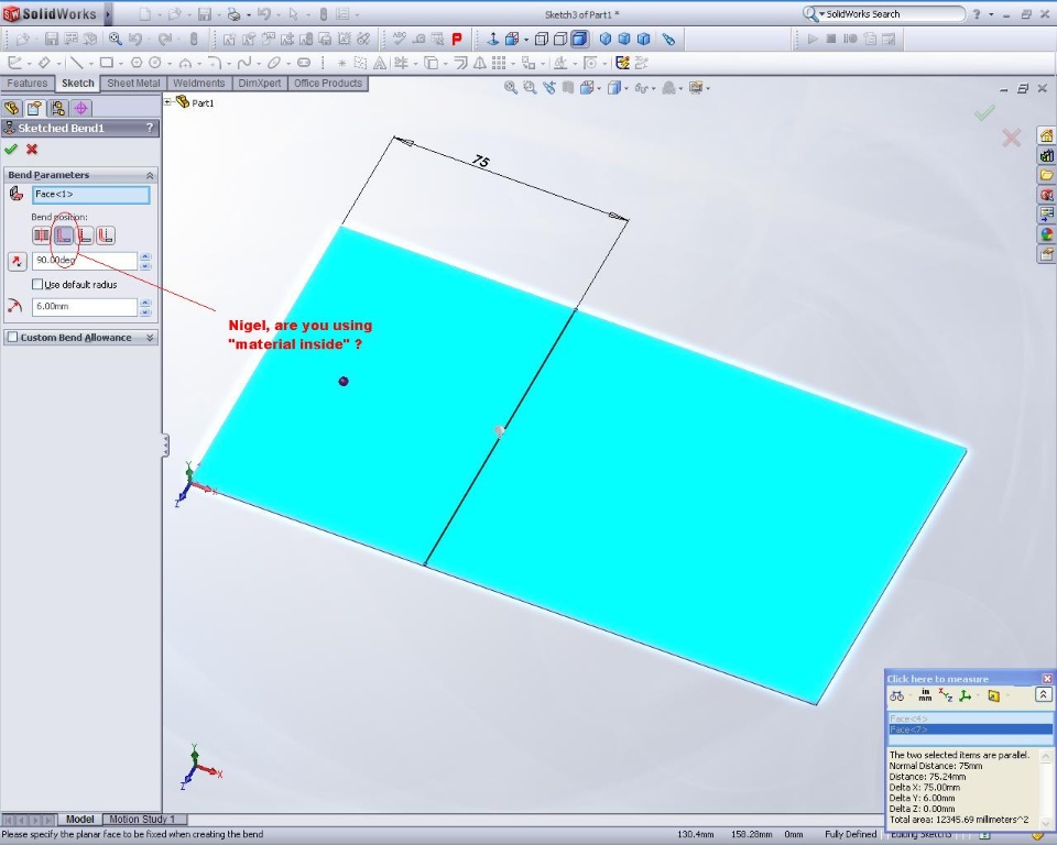

I have a piece of plate 6mm thk with an internal bend radiusof 6.6mm bent at 90 degrees. The flange length(or height) I amafter is 54mm. However when I dimension the bend line at 54mm theflange height is 66mm with bend at centre line selected. I know Iam missing some maths when it comes to positioning the sketch,initially and I was wondering if someone could point me in theright direction for my own understanding.
By the way I am using a Kfactor of .48
