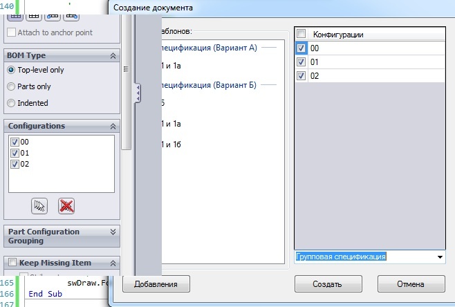

I receive configurations through BomFeature in  DataGridView. Tell me please how can I return meaning  from  DataGridView back in SolidWorks to show the BOM table with chosen configurations?
I receive configurations in this way:

        ' insert configuration in DTG
        For i = 0 To UBound(Names)
            DataGridConfig.Rows.Add(boolStatus, Names(i))
        Next i
