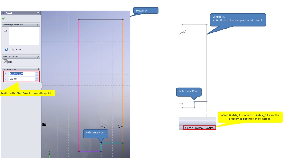

Hi everyone,
     I have two sketches, Sketch_A and Sketch_B, Sketch_A is being copied to Sketch_B together with other sketches.
     I want to get the new startpoint a line on Sketch_A after it was copied to Sketch_B.
     I'm currently using Sketchline:: GetStartPoint2 but the return value is the x, y, z of the line on Sketch_A.
     What workaround should I do before using this function so that it would return the line's x, y, z based from the Sketch_B.
     Please see the attached file for futher discussion, if my question is still vague, please let me know.
