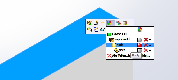

I tried to get/set (change) the color of a body from a STEP-File imported.
The code is as follows:
var importFileData = _solidWorks.GetImportFileData("part.stp");
int errors = 0;
_solidWorks.LoadFile4("part.stp", "", importFileData, ref errors);
IPartDoc part = _solidWorks.ActiveDoc as IPartDoc;
IModelDoc2 model = _solidWorks.ActiveDoc as IModelDoc2;
var bodiesAsObject = (object[])part.GetBodies2((int)swBodyType_e.swAllBodies, false);
SelectionMgr swSelMgr = (SelectionMgr)model.SelectionManager;
SelectData swSelData = (SelectData)swSelMgr.CreateSelectData();
var bodies = bodiesAsObject.Cast().ToArray();
foreach (IBody2 body in bodies) {
  if(null != body.MaterialPropertyValues2) {
    var material = body.MaterialPropertyValues2 as double[];
    body.Select2(false, swSelData);
    material[0] = 1;
    material[1] = 0;
    material[2] = 0;
    body.MaterialPropertyValues2 = material;
    model.ForceRebuild3(false);
The result is as follows:
As you can see, “Body” gets the new color assigned.
But I need to set the color of “Importiert1” – how can I achieve this?
Please find the STEP-File attached.
Thanks,
Alex
