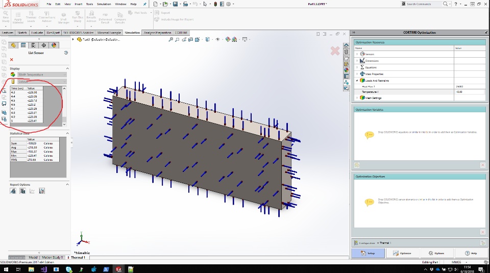

What i am looking is access to this data:
This is accessed by right clicking the sensor and selecting "list"
