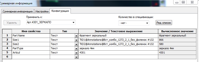

I have one detail(part). It has configuration properties like this:
So 5 properties total.

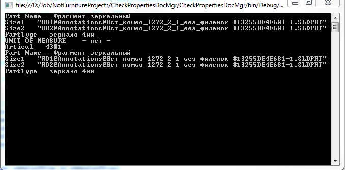

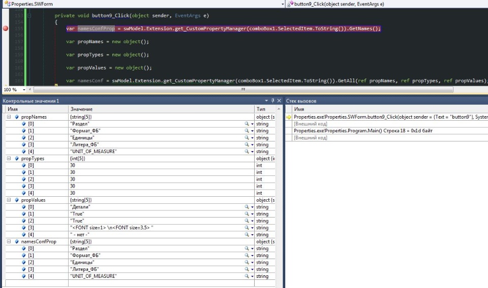

When I use API like that:
                    var namesConfProp = model.Extension.get_CustomPropertyManager(nameConfig).GetNames();
                    var propNames = new object();
                    var propTypes = new object();
                    var propValues = new object();
                    model.Extension.get_CustomPropertyManager(nameConfig).GetAll(ref propNames, ref propTypes,ref propValues);
In propNames and other return objects i have 10 prop. total:
Some of them doubled. Some did not. Other details(parts) are good, and API returns same properties as i see in SW window.
But on this detail(part) in SW window I see 5 properties and API return 10, some of them doubled as i sead.
