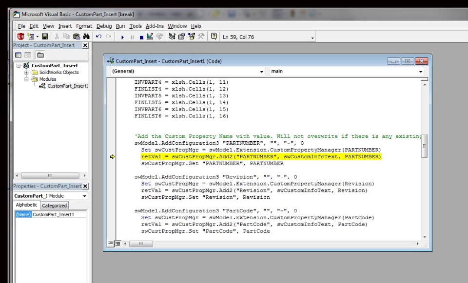

OK, I hope I can ask for some help here as I've done as much as I can with my experience level.
I'm trying to write a number of configuration specific custom properties to an assembly file for use in drawing automation. I'm pulling the data from an Excel file where I keep all the information on the models, part numbers, revisions, paint codes, ect. I currently have it working using the property tab builder but a bit more automation would help a lot and most likely prevent some transcription errors.
I'm using SW 2012 for this project.
I've copied and modified code from the web and have this:

It errors out and presents me with an Object varible error 91.
I can see during debug that it successfully reads the Excel file and has the proper data associated with the custom property names but I see this at the break: (I imagine I would see this at every break.)
I must have some stupid error here and I'm ready to give up. I would appreciate any and all help! Thanks!
