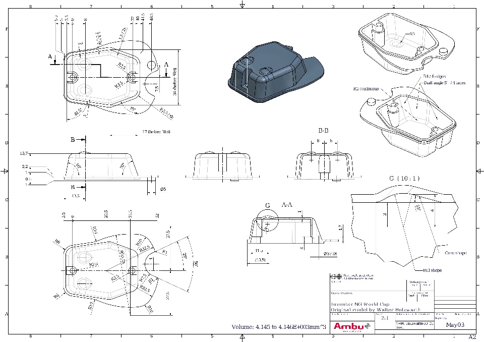

I am fairly new to SW (took an intro class); I'm working on replicating some part drawings that someone sent me for practice, and I have a question about dimensioning.  I am seeing some dimensions that say:  15,7   or     2,2     etc.....What does the comma between the numbers mean?  I am sure it's not a decimal point, definitely commas.  Thanks for helping out a noob!SolidworksDrawings And Detailing

Yeah, you're absolutely right, here's the part.  The dimensions in question are on the side of the elevation that's located on the middle left of the page.

The comma convention is the standard for showing the decimal point when using a metric standard.
You appear to have mixed standards ... or someone has made an overide of those dimension.

The seperator can be changed at Tools > Options > System Options > General ---- Use sytem seperator for dimensions
