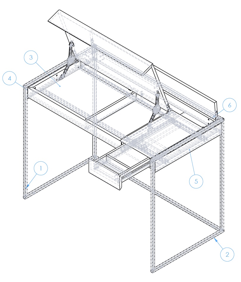

I'm at my wits end. I have to send a drawing pack out to a client, the pack in SW is fine. However when I save as a PDF the hidden dashed lines come to the front and get mixed up as in the attached screen grab.

Hey, I think I found a solution to hidden lines showing when exporting to PDF.
In the parent view in the drawing
(1) Select Hidden Lines Removed Box
(2) Select "High Quality" for Display style and Cosmetic Thread Display
(3) Under Save View as.... Click More Properties
      • Click the tab Show Hidden Edges and delete everything inside of it
Also under options, select High Quality for Display Style under Drawings.
Under Export, Select PDF and choose these settings.
Changing these settings fixed my Save As PDF settings. The PDFs are high quality and do not show hidden lines.
