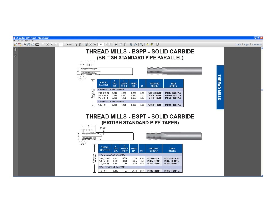

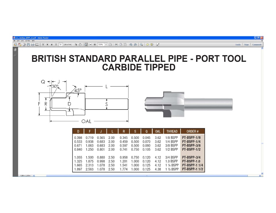

Sometimes you need too look outside Solidworks for your information.

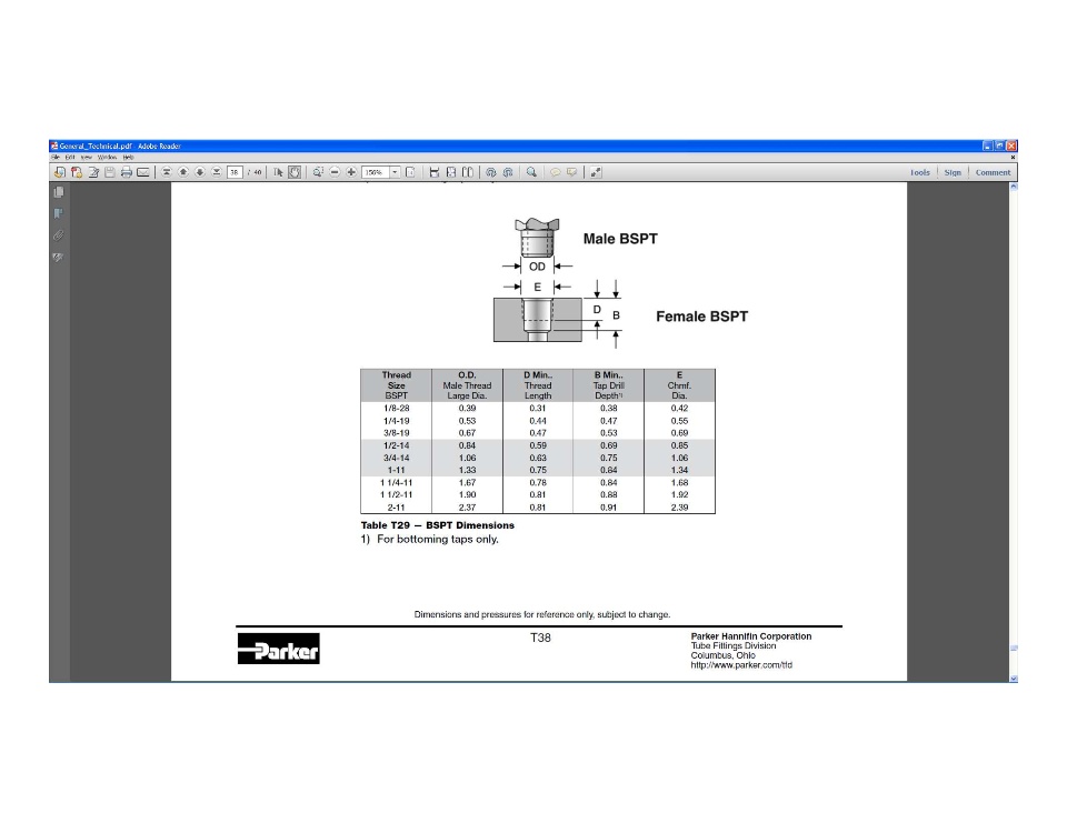

In this case when I needed BSPP & BSPT port and thread information I looked for the tooling that the machinist would use or the fitting manufacturer in this case Parker.
Look at page T36 in the GENERAL_TECHNICAL PDF for BSPP port information.
For BSPT tap drill size do a Google search.
I made a SLDLFP file for the BSPP ports (see Solidworks help on how to make those files) they save a lot of time if you have many ports in your manifold.
