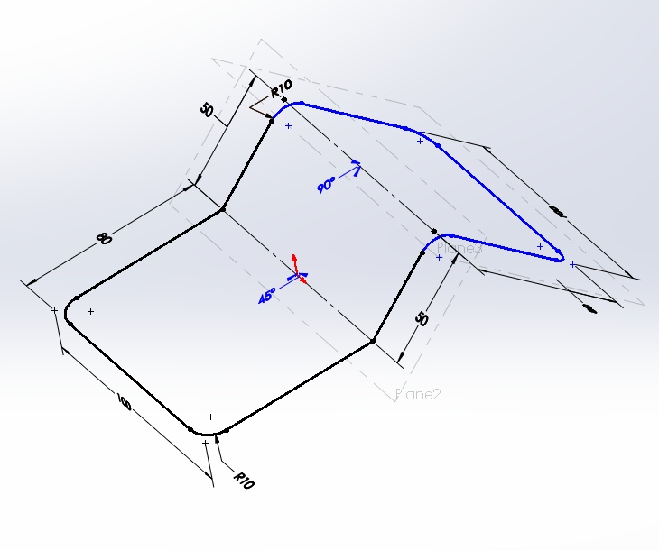

Start with basics, try dimensioning anything blue again, start with the straight lines. You will also note that your blue corner arcs (furthest right) show no radius.
Dave.
MN
MN2017-10-29
Whatever dimension I gave it became like this.
DB
DB2017-10-29
I actually meant these corner arcs........
MN
MN2017-10-29
Result is same.
DB
DB2017-10-29
That's because it's over-defining it now........
Can you try and fully define these two points on Plane 3 ?????
I replicated your sketch but without the planes. I also couldn't quite make out the last length (right) so I made it 60MM.
I had no problems at all with it being fully defined. I have attached my file for you to look at (2016 SP3) You may need the planes for a specific reason, if so, you could still add them using sketch references.

I wish to know whether this can be any use if line is not along X, Y, or Z axis.
I first added 3 construction lines to the midpoints of your 3 lines (yellow arrows).
Second I added the 50 dimension to the middle construction line (green arrow)
Third, because this new dimension over-defined the sketch, I deleted the front 50 dimension (red arrow)
Done!
Actually, because this is a thin part, my approach would have been to do those 3 construction lines as solid lines in a new sketch (on the front plane). Then add a sketch fillet and do a thin mid-plane extrude. Then fillet the solid corners.
