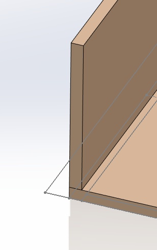

I've just installed a Quadro P1000 in my workstation (previous user installed gaming cards in all of the CAD workstations here). This is the same card I had at a previous employer and had great performance with it. I've been going through various settings for an hour so and searched around for this issue but I couldn't find anything.
The FSAA setting is not being applied to sketch entities, including dimension values. Model edges are receiving AA. Anyone experience this and have a solution?

I've tried a few different things since my last reply. If I change the AA setting to "Anti-alias edges/sketches only", I am now seeing my sketches and dimension values with AA applied. However, now my 3D model edges are jagged. FSAA does not seem to be working correctly with this P1000.
It may also be worth noting that with the previous video card (GTX 1060, no certified drivers available), FSAA worked flawlessly in all situations.

We have updated from SWX2018 to SWX2021. We have the sam behaviour. When we activate the fsaa feature with the enhanced graphics, the 3D-bodies are fine aa and the sketches arre jagged with no aa. (Quadro P4000, newest ceritified driver)
