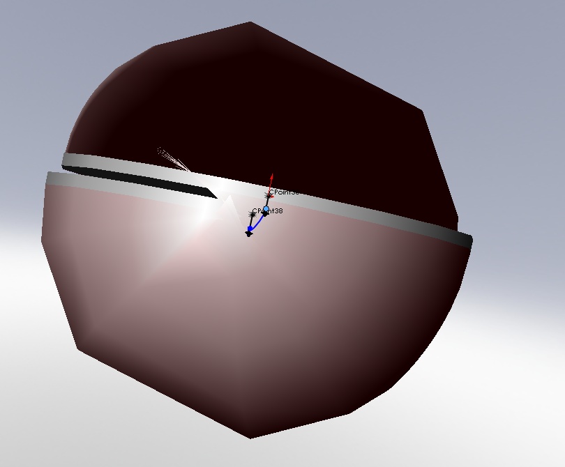

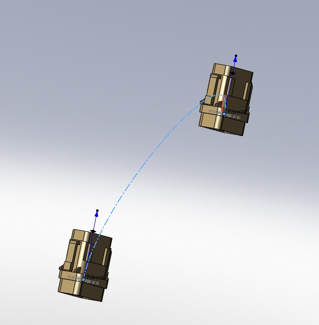

Hey I am trying to use a from to list to import route data, but I keep getting errors.  When I insert the connectors they are facing the opposite way of what I would like them to be, and I can't mate them to change the orientation or I lose the routing options from the from to list.  Is there a way to mate the connectors and still have the setup options from the from to list?

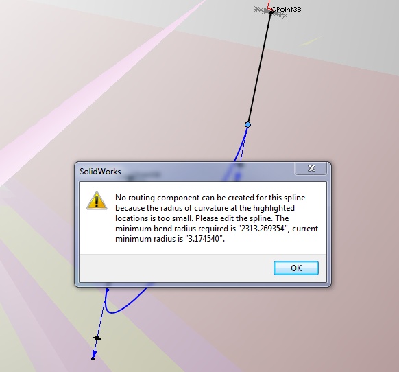

Also, when I try to go ahead and route with them facing the same direction, it gives me an error that the bend radius is to small, and then when I try to manually change the spline it turns into a flying saucer (see pics).  After that if I do auto route it goes all death star on me.

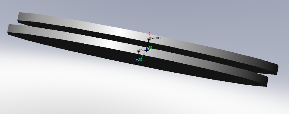

also when I go through the whole from to process and then mate the connectors after the route has been created so that it is just a straight shot between the connectors, all the error readings are resolved in the design tree, but it looks like the attached picture

I think your wire diameter in your wire library is incorrect.  I believe the units are meters.  If you assumed them to be mm your wires will be 1000x too large, which is how they appear in the pic.

Yes, Chris is right.   All dimensions in the wire library need to be in metres.  Metres are the units SW uses internally.
