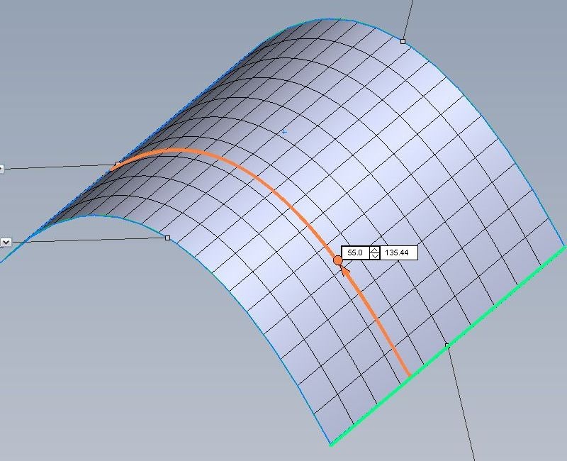

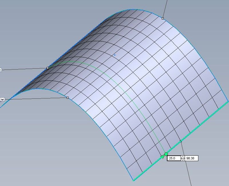

Edit: attach are some concept pics of a realtime running distancebox to aid curve and point placement -just one approach that cameto mind you understand
In this example you pick an edge and slide the cursor along untilthe desired point
- the box gives the running position and the overall length
Having placed the curve the box then follows the point placement insimilar fashionSolidworksSurfacing
