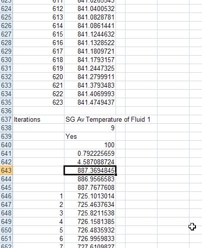

Okay, I'm fine with the goal plot itself.  But out of curiosity, what are the extra rows in the Excel data.
Pictured below is a data file.  The top is the end of one goal, the bottom is the beginning of another.  The data all ends at the same point (iterations vs temperature).  The beginning shows an offset with a series of values.
I'm assuming the "Yes" refers to the state of the "use value for convergence" setting.  And perhaps the 100 is the % convergence.
Does anyone know the rest of the values represent?
