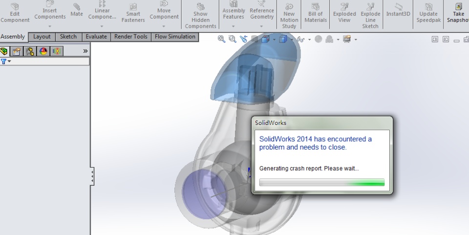

dear all,
          i learn flow simulation those days, but the flow simulation crashes when i run the exmaple of ball valve,and all the other samples are same. I tried to enable the OPENGL, and didn't work. my computer's hardware list below:
                        CPU: I5
                        graphics card:intel HD GRAPHICS 400  Integrated graphics
                                                    Geforce gt630m    discrete graphics
                       OS: WIN7 32
  the attached  is the snapping picture of crashing.

what variant of win 7 32-bit? home?
did this ever work on this system?

hi, thank you for your response.
My OS is win7 32-bit professional and the Flow Simulation never worked in the system. but the other add-in is very stable. .i tried solidworks 2013 and 2014, the phenomenon is same,So I think if the graphic card is not suitalble for solidworks, or should i swith a graphic card?

if you enabled software opengl that should point out whether graphics is the problem or not.
have you spoken to your reseller about this yet? i'd be pointing you towards disabling the graphics card completely. disabling optimius. disabling UAC and then potentially a full uninstall/reinstall before going to a new computer. but overall your computer is supported except for the graphics card.

there are no any message about grahic cards except the "solidworks has encounted a probelm and need to close".
i don't consult to reseller yet. i'd like try your suggestions to disable grahpics card,disabling optimius,disabling UAC and to see if it could help.
