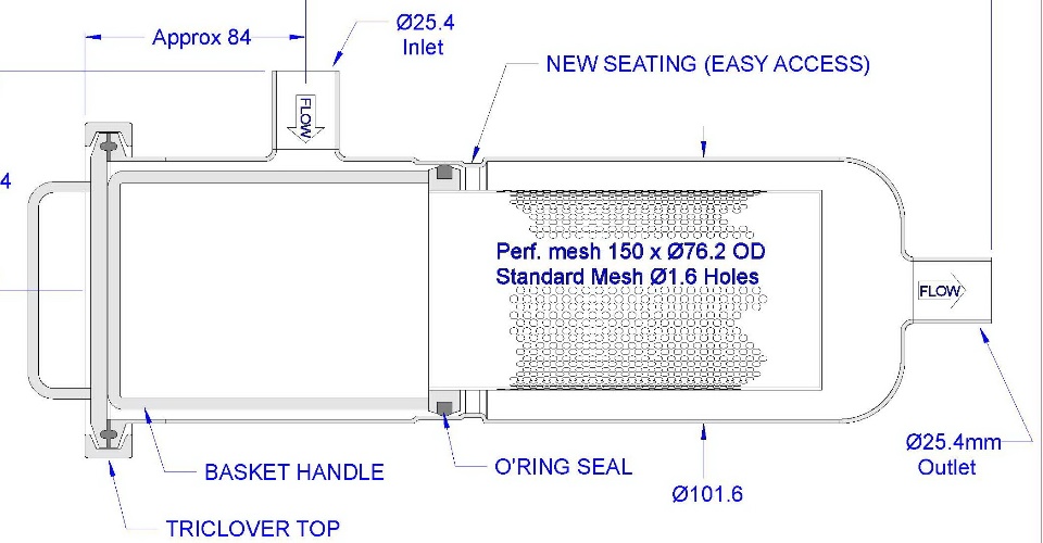

I need to measure pressure drop at the outlet.
I have seen videos showing pressure drop in a globe valve, but wondering if it is possible to show pressure drop after the liquid has passed through a perforated basket.
BB
BB 2018-01-24
Maybe this drawing shows it better.
This basket is fabricated from 10mm perforated sheet.
I would like to be able to measure the pressure drop, inlet compared to outlet.
Perforated baskets range from 0.5mm to 12mm holes, with countless combinations of basket lengths and basket diameters.
Customers are continually asking us what the flow rates are of our baskets, and without building an elaborate testing bench, then testing every possible configuration, we are unable to answer.
comment imagecomment image
BM
BM 2018-01-24
If it were me I would calibrate a porous media element to simulate the mesh and use that porous media to get data on the installed configuration (basket). But of course you can always use the brute force approach but that is a lot of detail model well.
