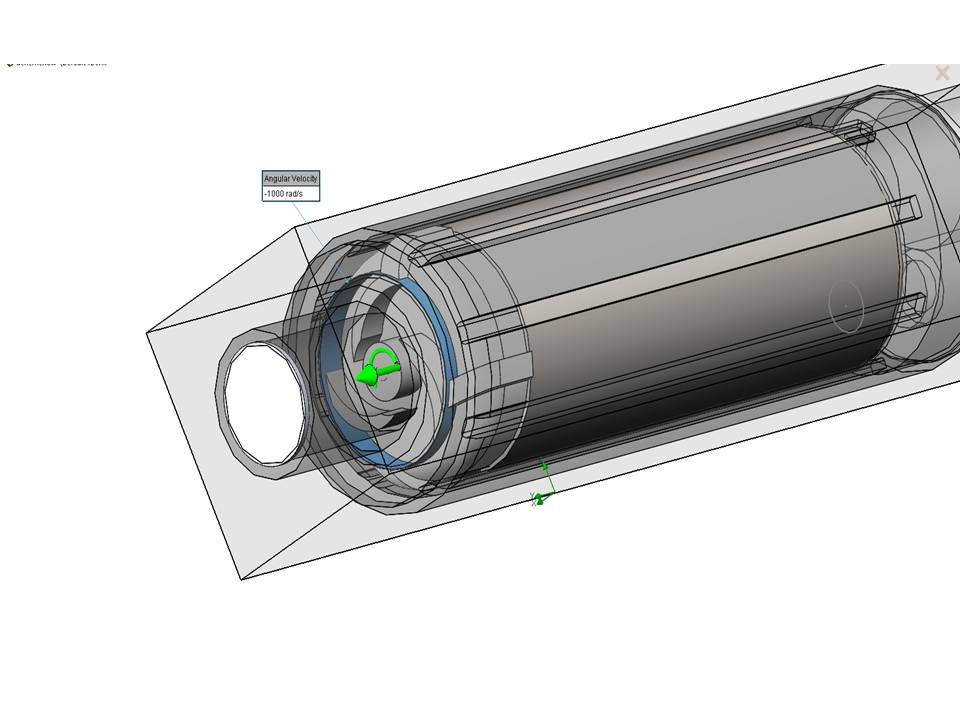

The picture that I attached is showing a pump which I am trying to find the flow velocity near blade surfaces. I added a cylindirical area around impeller and applied rotating frame. For the first trial my BC's are
1) Inlet Flow Rate;
2) Outlet Environment Pressure;
3) Real Wall to Impeller;
4) Real Wall as Stator to Water touching faces inside the pump.
As a second study I deleted the rotating frame and applied these boundaries;
1) Inlet Flow Rate;
3) Real Wall as Wall Motion to Impeller's Water touching faces.
Which one do you think is the best and the most logical way to do that kind of study?
