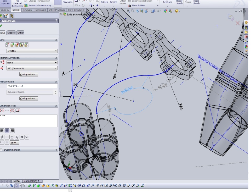

how do i flip an arc length dimension?
in the attached picture that 261mm dimsion is the outer arc length dimension. i would like to flip it to read the other side of the arc which is about 144mm.
the funny thing is when i start off dimensioning it it shows it as 144mm but when i click ok and place the dimension it changes it to 261mm.
i am trying to use it to form an equation but if its showing the wrong value it makes things a bit harder.
also does anyone know how when dimensioning a sketch to make the dimension driven straight away rather than doing ti twice waiting for it to come up with that error message warning you of an overdefined sketch then deleting the driving dimension?

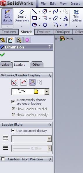

to flip arc dim,
under your dimension manager, click on the leaders tab, then choose arc condition, you can change it here.

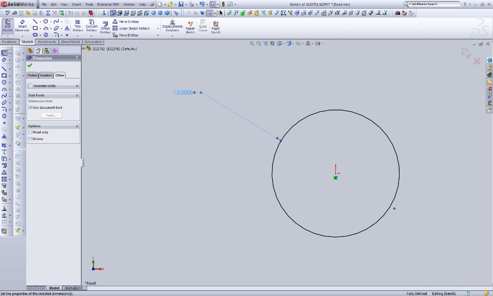

Hi Justin,
Referring to your driven dimension question, you can choose to make it driven before you click whatever you are dimensioning.  In the Dimension Window select the Other tab and at the bottom are the Options.  Just click on the Driven box and your next dimension will be driven.  Hope this is what you are looking for.
Ryan W.
SF
SF 2010-09-29
Justin,
If after placing a dimension you want to make it driven, RMB on the dimension and select Driven.

clicking the different arc leaders only changes where the arrows are placed and not where the arc length is taken as.
JS
JS 2010-09-30
I've noticed that if i make the dimension driving then it select the correct side of the arc but when i make it driven it selects the wrong side.
i resorted to writing my equation working out the circumference of the circle then subtracting the wrong sided arc length. i tried using a angle dimension in radians and multiplying by the radius but it kept on multiplying the degree value of the angle by the radius and giving me the wrong result for the arc length.
Why does solidworks have to be so difficult for such simple things and make other complex things so simple like sheet metal?

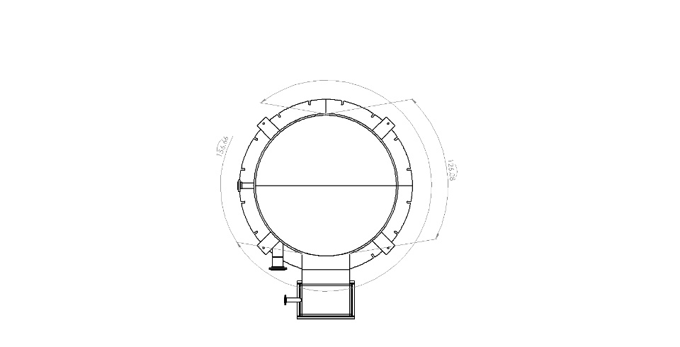

Has anyone come up with a good answer for this problem? I have the same issue trying to get an arc length. I am trying to dimension two arcs that are the same length but one will dimension correctly and the other wants to show the dimension the wrong way around the arc. This was originally just one view on another drawing so I put just the one view on a separate drawing to see if that would help but I get the same result. Any help is appreciated.
JS
JS 2014-09-26
I don't know of a good solution. I would just convert entities to make a sketched arc, then try dimensioning that and see if it displays correctly. If that doesn't work try just sketching an arc out in space and dimension it so it displays correctly, then make the dimension driven and add relations to move that arc on top of the model geometry.
