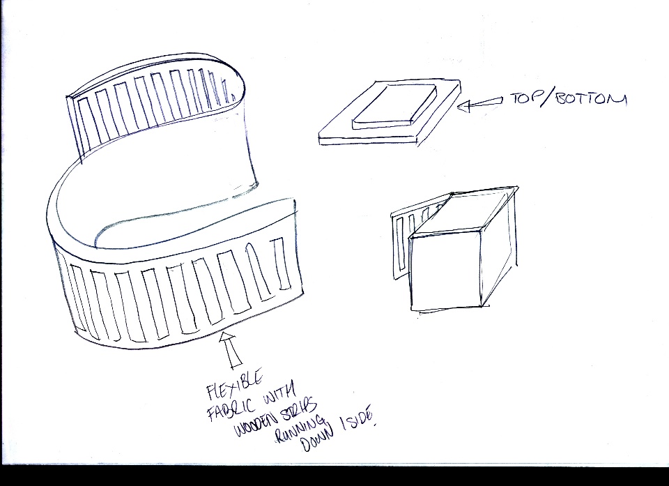

hi there. i have been asked by my tutor to come up with a design concept for an eco friendly exhibition stand and then model it in solidworks. But what i want to do is completly new to me. I need to create a flexible wall. I have attached some images to help better explain what i want to do. If anyone would be able to help me with this it would be greatly appreciated.

Im not sure what you mean? I want to know how to make a flexible fabric with strips to provide support so that it can wrap around curves and then be held in place to act as a wall of an assembaly

"Flexible" is the tough part if you actually need this wall to move - but you could create configurations if you just need to see more than one position.
You can try to create a sketch that defines the "fabric" and then use a Curve Driven Pattern to locate the strips.

that would be perfect for what i want to do. how do you do a curved pattern?

Im not how you did this with the strips i've found videos that tell you how to do it with holes but im still unsure how to achieve this. i know its with the curve driven pattern tool

I just made a rectangular extrusion and patterned the body.

I'll try to describe the steps -
1. Make a sketch of the shape you want
2. I used Fit Spline to turn the sketch into a single entity
3. Extrude the sketch as a thin extrusion (ie, the wall)
4. Sketched a rectangle that is located on the curve from the previous sketch
5. Extrude the rectangle being sure to uncheck Merge Results leaving you with a multibody part
6. Use Curve Driven Pattern to pattern the "strip" body
In this picture I am showing the sketches I used - the blue is the "wall" the magenta is the "strip"

Im actually a little unsure about the fitspline stage. what do you mean?

Oh...ive done it. Thankyou very much of you. You have been really helpful and i really appreciate it
